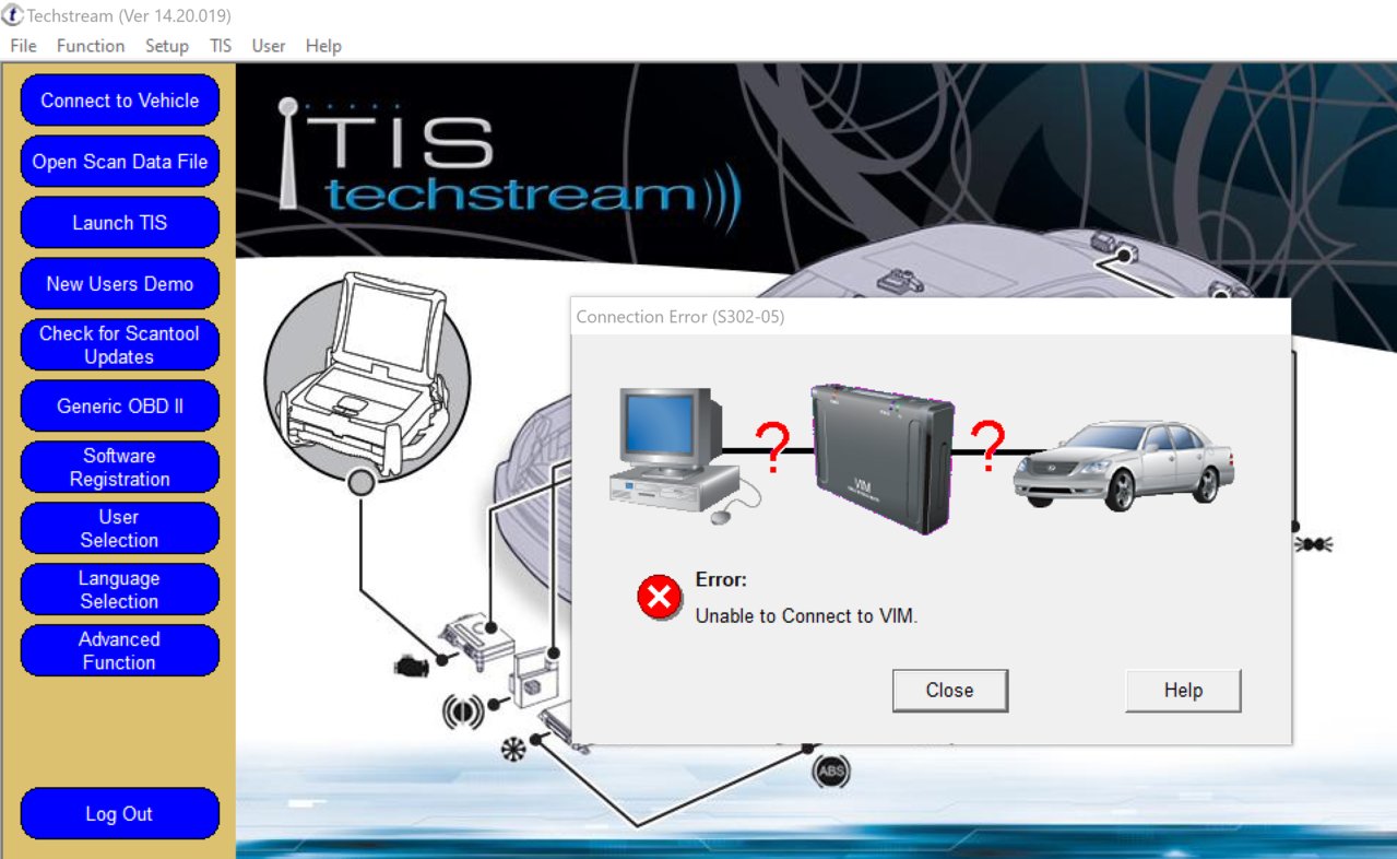

    Right, not connected to wifi, no on the java, and selection of drivers from 3 available choices, two are OpenPort with a 32/64bit distinction. I'm running Win10 64bit on a new machine with two legacy USB-A ports and two USB-C ports. I've got a plethra of cables and adapters for pro camera gear and not one is working.
    I've been reading under a google search using: "connection error (S302-05) tactrix" and it looks like it's a driver issue and i'm not finding anyone that has broken past the error. But most of these are not using tactrix, but they are using techstream and these posts in various Lexus/Toyota forums go back 5 years or so. I may see if my neighbor has an older windows laptop to try.

    It is most likely a driver issue, but hardware is a possibility (not very likely). Somehow you have more than one driver installed and your computer is not using the right one. If you can figure out which two drivers are installed, you can manually delete them both. You can also try disabling driver signing and reinstalling. That shouldn't be the issue as I have never heard of anyone having to do that yet. It is windows though so anything is possible.

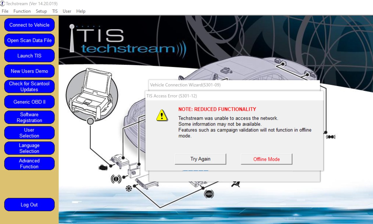

    So firstly, thanks to everyone who jumps in to help with valid suggestions and steps. Based on the broad reading with the error code related to techstream using other connectors it had to be the driver. So did a full uninstall just like before to start fresh. I ran a search for tactrix drivers on the openport 2.0 and downloaded an older version from their site located here: https://www.tactrix.com/index.php?option=com_content&view=category&layout=blog&id=38& It looks to be an older version when compared to the driver link in the top of this thread, unless they are going backwards in version #'s
    Still gave two choices within the VIM selection, one 32 and the other 64. Tried the 64 bit version first and got the same error, but holy mother of all that's holy the 32bit version worked for the update! However, I'm not sure Techstream is connecting fully unless this is a normal mode of operation to get in. I clicked offline mode and got into a few screens but ran out of time to dig in.

    Yes. We're offline for all this stuff.
    Online is a paid TIS subscription.
