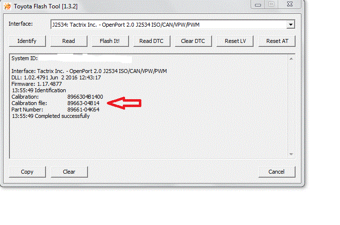

  12. Jan 24, 2021 at 2:45 PM
    #4072
    mlua805
    mlua805 Member
    Apr 2, 2019
    #288848
    14
    2017 Tacoma Off-Road 6MT
    URD SPEC-U Exhaust< Black Widow Muffler , VFTuned
    Well I finally did it. Officially updated my ecu to 04B14 on my 2017. Thank you guys
    ERod27 and Shellshock like this.

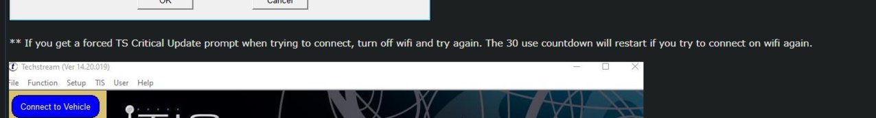

  13. Jan 26, 2021 at 9:06 AM
    #4073
    jjs2608
    jjs2608 Member
    Feb 2, 2020
    #318037
    24
    Jacob
    2019 Tacoma OR DCSB
    Ran it today and it is saying I have to update to the new version to do anything (running 14.20.019). It takes me back to toyotas site to download the new one which requires a valid login. Anybody else having this problem?
  14. Jan 26, 2021 at 9:09 AM
    #4074
    stonedraiders
    stonedraiders Member
    Jan 14, 2021
    #352759
    18
    Mario
    2019 Toyota Tacoma
    none
    I saw a few post that all u have to do is disconnect from internet. Then u can run it.
    tonered[OP] likes this.
  15. Jan 26, 2021 at 9:09 AM
    #4075
    tonered
    tonered [OP] bartheloni
    Sep 25, 2017
    #231055
    31,330
    tony
    Lynnwood, WA
    Close the sit. Turn off wifi. It will tell you that you have 30 uses remaining. If you accidentally connect while on wifi, the countdown will reset.
    jjs2608[QUOTED] likes this.

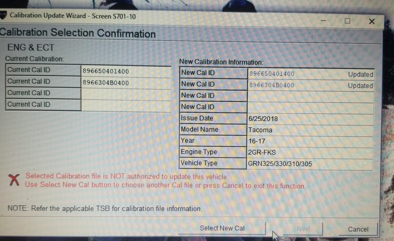

  18. Jan 26, 2021 at 7:54 PM
    #4078
    JG358
    JG358 Well-Known Member
    Feb 19, 2020
    #319760
    240
    Jake
    Colorado
    16 Tacoma TRD OR DCSB
    I feel like a dummy fighting this flash. 2016 AT, conected via Tactrix openport 2.0, Using CUW T0034-18 and I get this when I double click the CUW file
    Lol, feel bad bugging Tonered so much via PM so figured I'd post up here. I'm sure its just operator error but I cant figure how I'm screwing it up.

    Shellshock
    Nov 21, 2015
    #170338
    23,601
    Iowa
    Look on the left. Your current cal is 04b04. That’s the latest TSB for your model year.
    JG358[QUOTED] and tonered[OP] like this.
  20. Jan 26, 2021 at 8:01 PM
    #4080
    dilbert
    dilbert AI Member
    Mar 14, 2016
    #181276
    2,861
    PNW
    2019 DCLB TRD Off-Road
    Your already at 04B04, that's the current ECU ID.
    tonered[OP] and JG358[QUOTED] like this.
