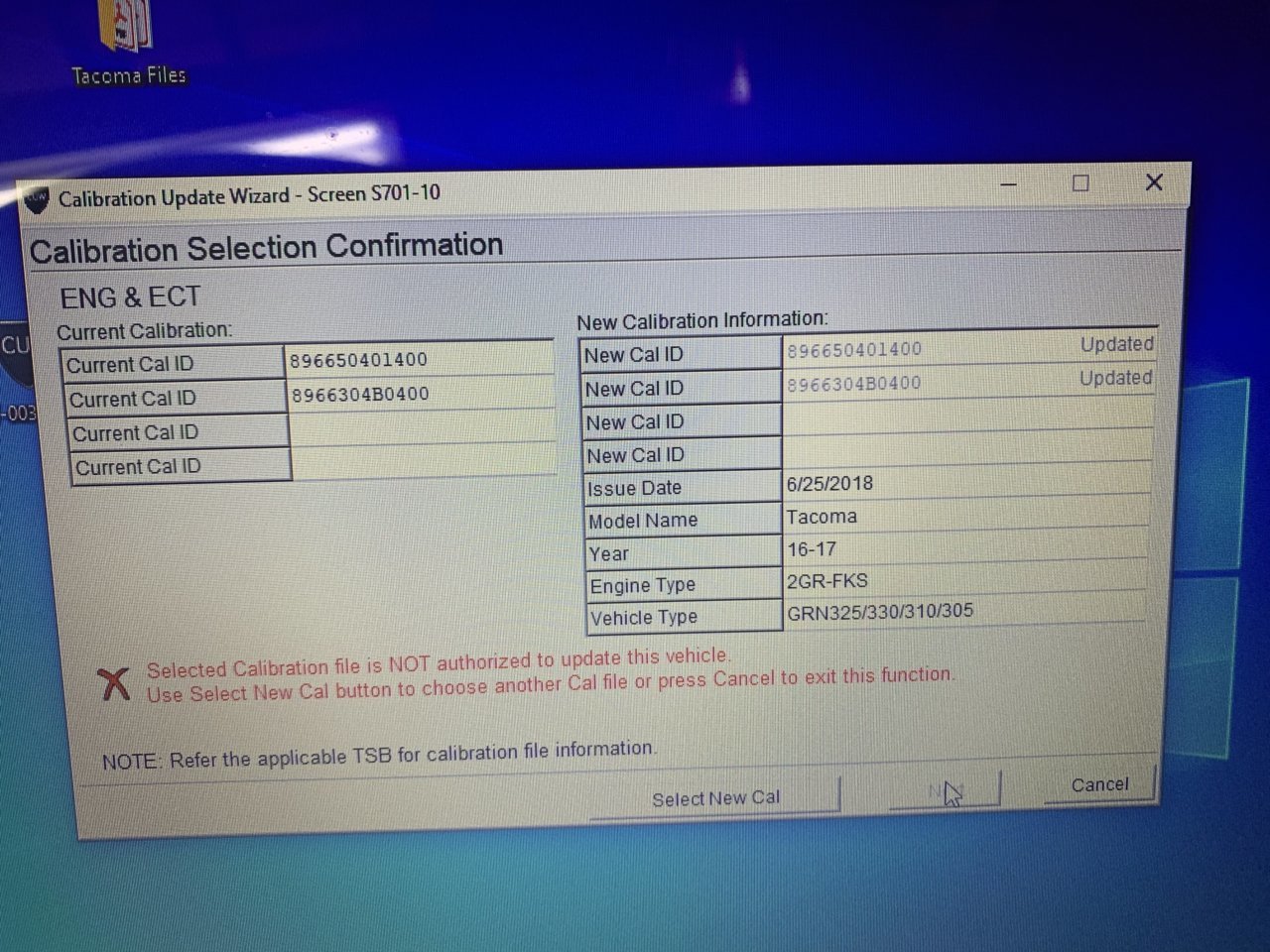

    I got the following error message. I canceled since I didnt want to mess anything up. Has anyone got this message when trying to update their ECU? What do I do next?
  9. Jan 29, 2021 at 9:09 AM
    #4089
    tonered
    tonered [OP] bartheloni
    Sep 25, 2017
    #231055
    31,242
    tony
    Lynnwood, WA
    It shows that your current ECU ID is already 04B04 in the left column. There's no update beyond that, yet.

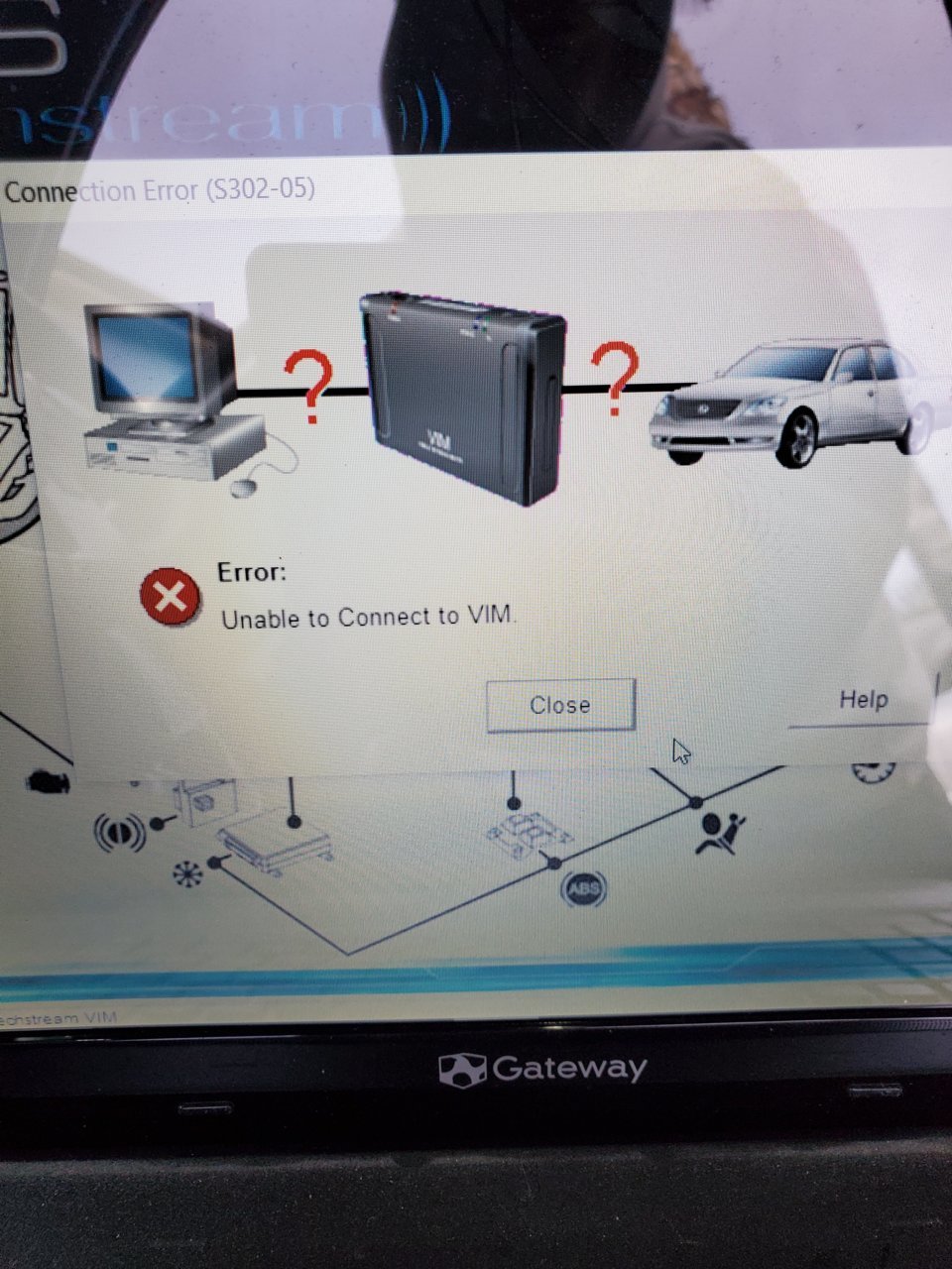

    I finally got my cable and trying to use TS. Coming up with this issue. The cable lites up and everything is working. But won't connect. I have the wifi off.

  15. Jan 29, 2021 at 10:21 AM
    #4095
    TacoTruck808
    TacoTruck808 Well-Known Member
    May 15, 2017
    #219102
    2,100
    Oahu in the Aloha State!
    2016 Tacoma TRD Sport DCSB, Prem & Tech Pkg, MGM
    Are you using a Genuine Tactrix cable? I used to get that message every so often using the cheap ebay one. I would NEVER trust the cheap ones to do an ECU update. I am not even sure the Amazon one linked below for $40 is Genuine.

  17. Jan 29, 2021 at 10:32 AM
    #4097
    stonedraiders
    stonedraiders Member
    Jan 14, 2021
    #352759
    18
    Mario
    2019 Toyota Tacoma
    none
    I was using Amazon cable. Trying to download drivers now. I'm running win
    im using cables from amazon. tried downloading drivers but it kept failing. gonna try your links. im using win 10. is this windows acceptable?
  18. Jan 29, 2021 at 10:34 AM
    #4098
    dilbert
    dilbert AI Member
    Mar 14, 2016
    #181276
    2,858
    PNW
    2019 DCLB TRD Off-Road
    I wouldn't flash the ECU with an Amazon cable. Customizations should be fine though.

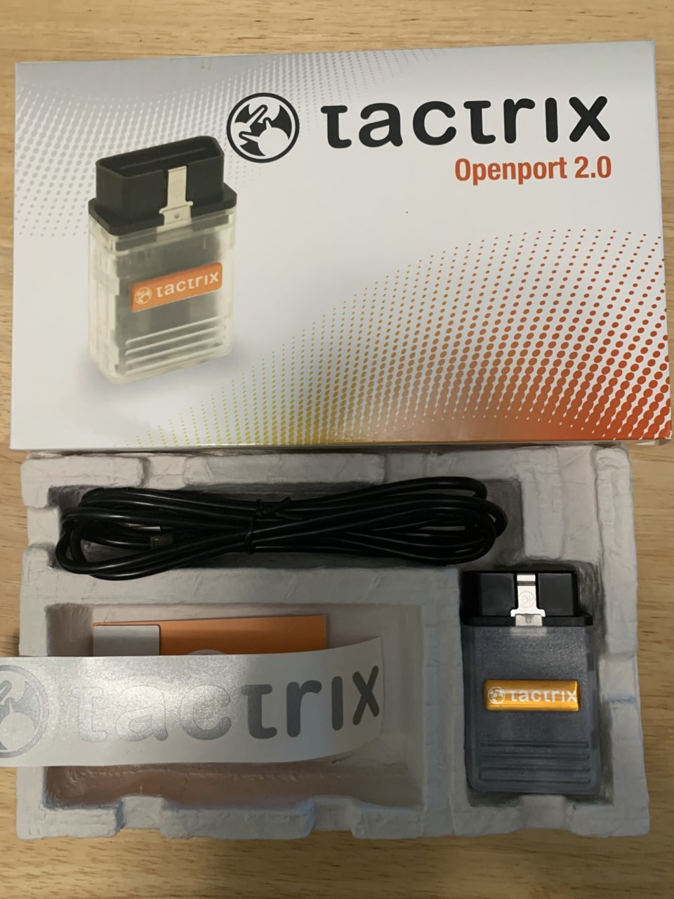

    I am using windows 10 and the Tactrix drivers that are linked in the first post and had no issues installing and connecting. This is what my cable looks like.
