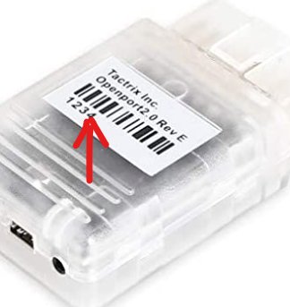

    It is not genuine, just a cheap clone:
    Beyond the janky S/N, the clear connector is another give away.

    Thank you all for the help. not trying to flash the ESU I'm mainly just trying to reprogram my fob key. i will purchase a new cable. sorry for being such a newbie lol.
  3. Jan 29, 2021 at 10:48 AM
    #4103
    tonered
    tonered [OP] bartheloni
    Sep 25, 2017
    #231055
    31,329
    tony
    Lynnwood, WA
    You're welcome!
    Do not use a clone cable for that either. It is a process that requires reliable comms. You don't want to mess up that ECU. I know the engine / AT ECU can be unbricked, but I have not seen anything on whatever ECU is used for the keys. Programming with TS and a Tactrix was very easy though.
    Note that the Tactrix will work on other brands, like Subaru, Mitsubishi, Mazda, and others if you have them.

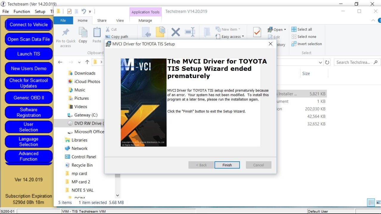

  13. Jan 29, 2021 at 11:02 AM
    #4113
    stonedraiders
    stonedraiders Member
    Jan 14, 2021
    #352759
    18
    Mario
    2019 Toyota Tacoma
    none
    this is what i get while trying to download the drivers on this cheap ass cable. im just going to have to break bread.
  14. Jan 29, 2021 at 11:03 AM
    #4114
    tonered
    Sep 25, 2017
    #231055
    31,329
    tony
    Lynnwood, WA
    I had some recent experience there.
    I had a new fob in hand for our Mazda. The key cut plus transponder programming was over $100. I still had to do the remote lock learning on my own. BTW, I did ask for only the key cut, but the guy was in automatic mode.
    For the @MESO FlipFob, it was $4 OOD to cut the key.
  15. Jan 29, 2021 at 11:04 AM
    #4115
    tonered
    Sep 25, 2017
    #231055
    31,329
    tony
    Lynnwood, WA
    You can either search out another (updated?) set of drivers or maybe try closing TS?
