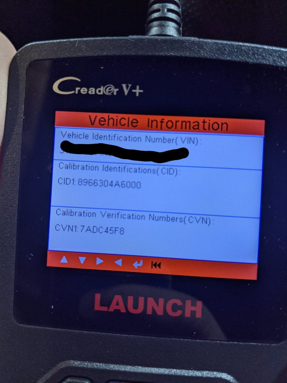

    Looks like my ECU has not been updated, correct?
