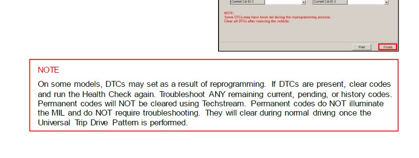

    As part of the TSB they reset the LV, AT, and clear DTC’s. Truck will be relearning it’s old ways so drive it aggressively while it’s relearning. It will be better than it was, but will still revert to many of its old ways as it “learns”.
    C41n likes this.

    That's an assumption. Attached are the current flash instructions, that step does not exist.
    Some shops will do the Resets, but most won't, just like applying the underhood label.

    Shellshock and C41n like this.
  18. Mar 5, 2021 at 9:38 AM

    I’ve done several, the wizard prompts you to clear DTC’s and I thought it also said to do the AT/LV. I’ll have to check my screen shots.

    DTCs are reset anytime a flash happens, just like they are when the battery is disconnected.
