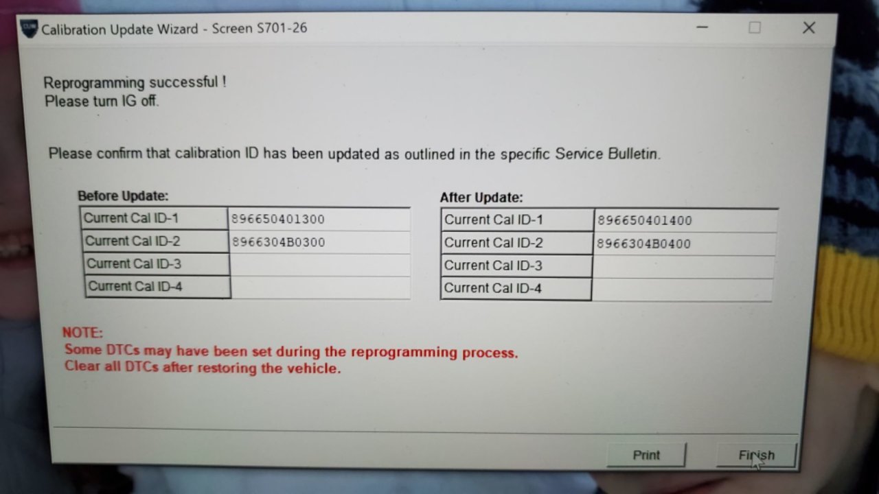

  11. Mar 5, 2021 at 5:48 PM
    #4431
    Bastek
    Bastek Average Member
    Jun 6, 2017
    #220876
    4,304
    Seb
    SI NY
    '17 OR dcsb
    KDMaxP10, plastidip
    It's done!! And the truck actually still runs!!
    Again, thank you guys for all your efforts to make this happen :thumbsup: (not all heros wear capes :D
    Now, I guess I'll drive around for a few days while researching OVt (or vF now) and changes they have made since I installed their software in December...
    ktbell444, C41n and tonered[OP] like this.

    #4433
    cbrrider98
    cbrrider98 Member
    Jan 2, 2019
    #277876
    9
    2017 Blazing Blue DCSB Offroad
    Same here. Just updated to 4B04. Was easy to do. Thanks for providing all the detailed info, really helped.
