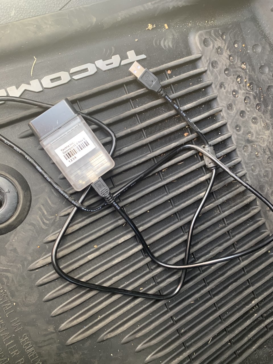

    Finished the update but I try to acces to reset values and system says update necessary
    wifi is off

    I think it’s all done..the truck start normally...will see..this one is from Amazon..probably a Chinese one but work without a problem..
  7. Mar 20, 2021 at 11:54 AM
    #4467
    tonered
    tonered [OP] bartheloni
    Sep 25, 2017
    #231055
    31,331
    tony
    Lynnwood, WA
    You got lucky. In the past on my bike, we worked together to find a cheap reliable cable. It was really easy to physically ruin those ECUs, but the collaboration was successful.
    If you partner with others on this particular unit, it might be proven to be a cheap and reliable option.
    Palanku[QUOTED] likes this.

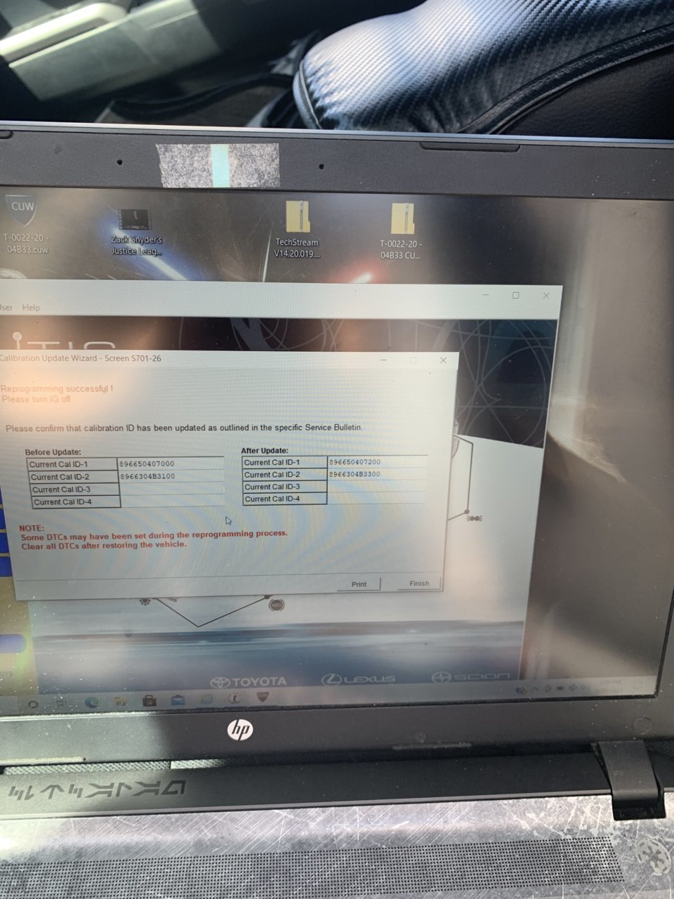

    Success! Finally decided to man up and just do it. Figured, what the hell...I can just drive my partners Kia Nero if I brick the ECU.
    Went from 04A60 to 04A61 on my 2018 AT. Now it's time to get out and drive!
