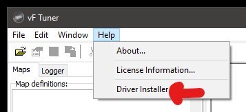

    Hey guys so I just hear back from Matt, he gave me the credits so that I could update to 04B33 but I’m having a little bit of trouble.
    I’m getting this error code: “unable to communicate with ECM. Cannot Prepare Writing E13.”
  9. Mar 24, 2021 at 9:11 AM
    #4509
    Shellshock
    Nov 21, 2015
    #170338
    23,480
    Iowa
    What are you doing?
    You need to update to b33 with TS, you cant directly flash to b33 with vF
    tonered[OP] likes this.
  10. Mar 24, 2021 at 9:12 AM
    #4510
    tonered
    tonered [OP] bartheloni
    Sep 25, 2017
    #231055
    31,267
    tony
    Lynnwood, WA
    Disconnect the Tactrix and shut down and restart vF.
    Be sure that you have the latest drivers installed:
    The Taco Ignition needs to be On without the engine running. Two taps of the PTS button without your foot on the brake.
    And, you need internet access for the Prepare ECU step to work properly.
    4x4G[QUOTED] likes this.
