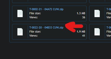

    What link specifically. I just DL'ed the CUW file that you need with no problem:
    Be sure to take your time and follow the instructions and prompts as best as you can.
    Shellshock likes this.

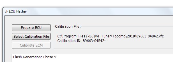

    Errm, does this look right? New VF download and it appears I can update my ecu to the lastest version through VF Tuner without the Techstream? There are tunes that were included with my download of Vf tuner. I have a 19' TRD OR 6MT, would this be the correct file to update the ECU to? (04B42)?

    Unfortunately no. At this time, you would just be forcing the 04B42 Stock tune on to your 04B40 or 04B41 ECU, which has caused rare soft-bricks long ago (the OVT Flash Manager days). Not sure if there would be a similar result with the newer software, but you don't want to play in that sand box.
    The only known way is to use the flash wizard in TechStream.
    Note that there is only the 04B42 Stock tune available from vF / OVT. The Tune Pack is not out yet. Hang tight there!

    The tune file needs to match your current ECU. There is a feature being worked on to update ECUs with vF but its still in development and no ETA
