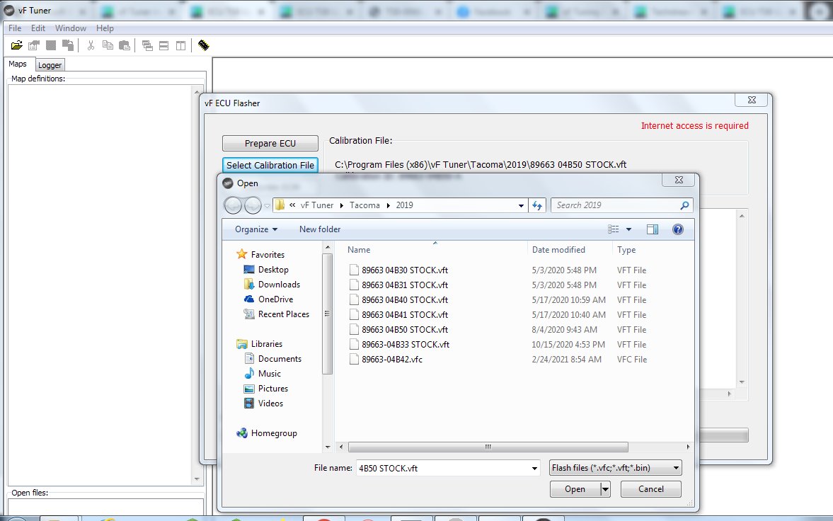

    Alright.... Got techstream installed - couple questions. I get a critical update message when trying to connect, can I mitigate this by turning off WIFI or does it need to be on to work? Second, I learned my truck is running 04B40, but there is no link on the 04B41 ECU file on here, only the 04B42. So would it be worth it to send Mat the ecu id and get the tune for my current version?
    Also, has anyone seen the latest directions on Vf tune website for v1.2.9.9. Pages 19-21 show him updating the ecu through vf. And included within my vf download are .vft and one .vfc files. I know I already kind of asked this but im not sure anyone understood. It SEEMS like I could update my ecu by calibrating my ECM with it on the Vf Tuner application. I mean, if its in the directions on the website it has to right... right.????

    Turn off WiFi when using techstream
    you cannot update ecus with vF. Don’t try

    Crap! Other than what @Shellshock said, I did goof up. You are right, there is no CUW to get from 04B04 to 04B41.

    Hey guys, so last week as y’all know I updated my 2019 TRD sport to 04B33. I emailed Mat and let him know that I was no longer on 04B31 (this was last Thursday 3/25). Still waiting to receive the new tune packs from him but he’s a busy guy so I can wait, but I had a few questions to smooth up the process of flashing those files when I get them.
    so I guess I’ll just list em off and whoever can answer them please feel free!
    The files I’m talking about (in case I forgot to mention) are like the 87 performance tune, 33’s, 35’s, etc. (yes the ect was a pun lol)
    1. when I receive these files should I expect them to be sent via Email?
    2. When going to flash these files is it through VF or through tech stream?
    3. Are each of the files flashed individually or can you pick a few and flash them at the same time?
    4. Will I have to tell the VF tuner “app” on my laptop that I’ve updated to 04B33 (since I updated through tech stream) or will it see that when it reads my ECUID?

    Yes email. Be sure to check your spam
    They will be flashed with vf like all the other tunes
    All the files are different tunes. You flash one of them. Flashing another will overwrite the previous one
    No you just tell it what to flash

    Not having the software makes wording this question a little difficult but how might I put all of those tunes into one file then flash that?

    The tune pack is a bunch of different tunes (different options like regular / premium / gears / tire sizes / etc and combinations of the different options). Theres no need to combine them. They are all for unique configurations

    What @Shellshock said, and all vF tuning is done with the vF software. Stock stuff and diagnostics are in TS.
