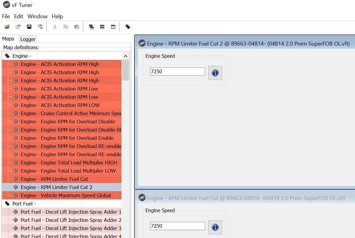

    What I know from playing around is that there are two rev limit maps that I believe need to match? Any OVT 2.0 MT tune has the rev limit set to 7,250rpm. Take a peek at one of those for a solid example.

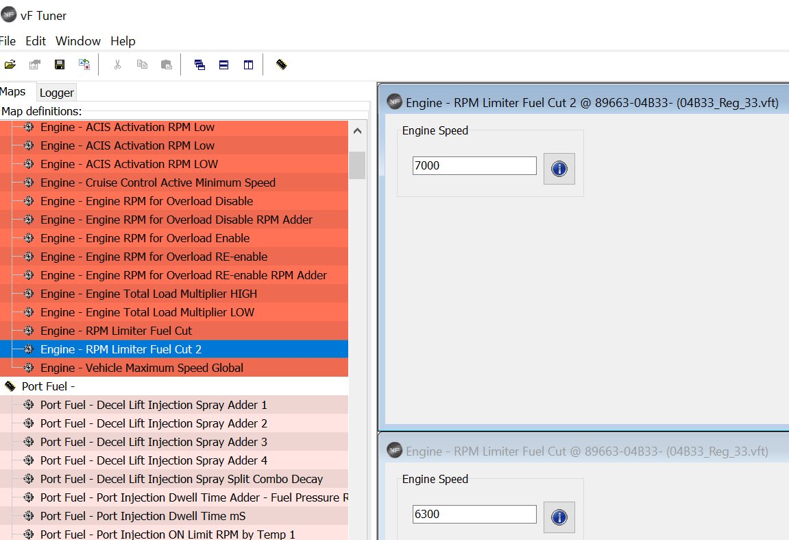

    Here's 04B33 unedited:

    See when I pulled that up for me both of them were 6300

    Weird. That is 04B33_Reg_33.vft. Other files could have other values. Still, 6,300rpm is goood.
