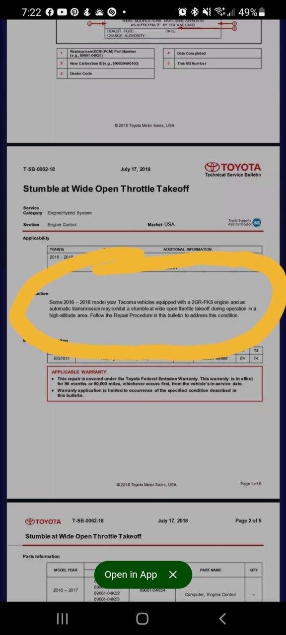

    2016 Taco offroad
    For who ever is building the friendly/nonfriendly dealership map you can put redding California toyota as nonfriendly. I called because I really do get a stumble and the truck dies at higher elevation (5500 to 7000) at WOT. I asked them if they would consider updating the ECU and was told first that there is no such TSB. When I offered to give them the TSB number I was told that if I drove it down and paid $280 for a diagnostic test. They might look up the TSB if they can reproduce the problem. Well Reddings elevation is 500 ft above sea level so my guess is it won't do it. Blah

    tonered
    tonered [OP] bartheloni
    Sep 25, 2017
    #231055
    31,342
    tony
    Lynnwood, WA
    The friendly/nonfriendly dealership map is updated by anyone.

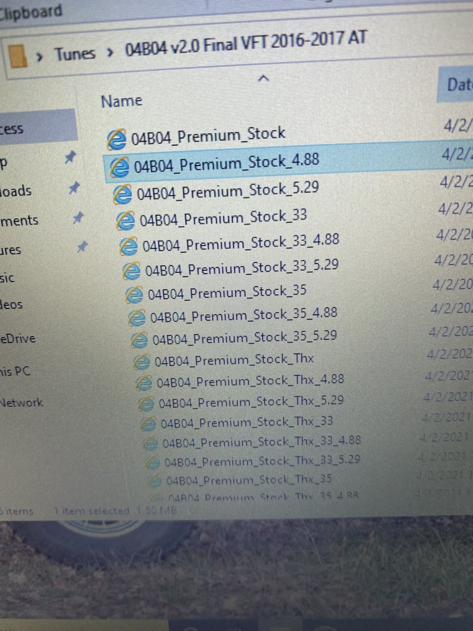

    My computer wants to use IE to open the files, will that mess it up when I go to flash the truck??

    #170338
    23,633
    Iowa
    Open the flash utility. Select the file. Flash it.
  15. Apr 2, 2021 at 11:34 AM

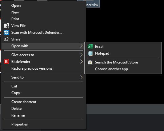

    It will not. But, if you right click and pick Open With and Choose another app, you can change the file association:

    Is there a preferred method?

    #231055
    31,342
    tony
    Lynnwood, WA
    I have opened them in NotePad in the past just to look. The whole file is encrypted data. No header info.
