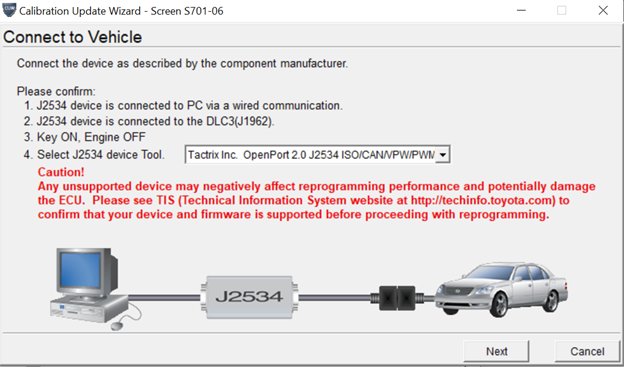

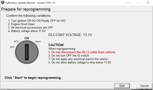

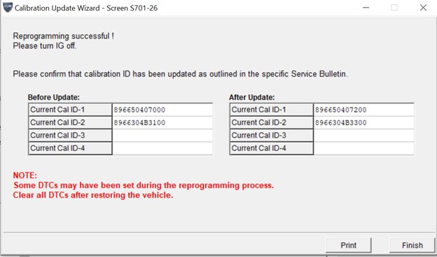

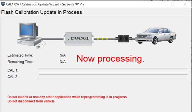

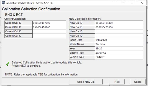

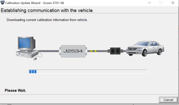

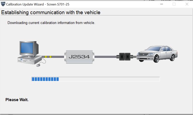

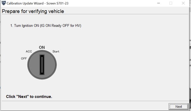

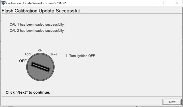

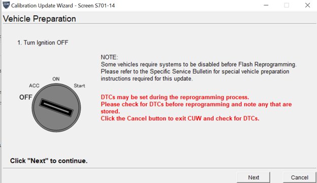

    Finally got around to updating my 19 OR from 04b31 to 04b33.
    I don't recall seeing any screen shots of what to expect so I took some along the way. May vary from year to year, but here is an idea.
    Whole process took less than 10 minutes from start to finish.

    Good stuff!
    There is no variance for year since it is part of the TS software.
    We do not have screenshots posted, but they are shown in TSB-0134-16.
    :cheers:

    Does the version matter? Where is everyone getting there’s? Trying to update my 2019 from 04b30 to 04b33
  5. Apr 10, 2021 at 3:14 PM
    #4685
    Shellshock
    Nov 21, 2015
    #170338
    23,628
    Iowa
    V14 is fine. It’s in the first post.

    I've got everything and doing the ECU TSB and the VFTune with KDMax 6.0. Today I charged my AGM battery on an 8 stage charger and ready to go. I'll turn everything off lights, etc. Anyone know if I'll be fine without a battery tender through the update and tune?
  18. Apr 17, 2021 at 8:49 AM
    #4698
    tonered
    tonered [OP] bartheloni
    Sep 25, 2017
    #231055
    31,339
    tony
    Lynnwood, WA
    You should be. If you can trust your battery to listen to the radio on Accessory for a half hour, your set for a 10min flash.
