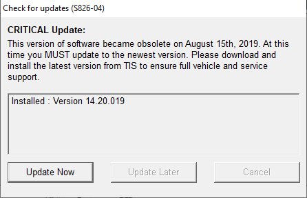

    You disconnect from the internet/wifi when you opened Techstream?

    Looks like you're connected to the internet ....... you shouldn't be........ disconnect and try again.
    Let us know if this is not the fix.

    I was disconnected from the internet and when I connected to the truck it said I needed the internet or work in offline mode. I tried doing the TSB update in the offline mode and it said I could not proceed without internet.

    Use Techstream in offline mode
    When doing ECU update, don't worry about opening up Techstream. Just double click on the .cuw file.

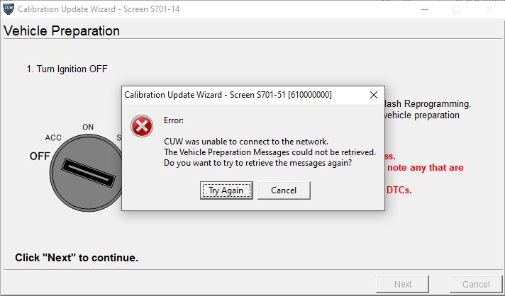

    I tried just clicking on the CUW file and went through the steps until I got this.

    Same deal. Cancel, and proceed.

    I got it!!!!! Thanks for all your help group.
