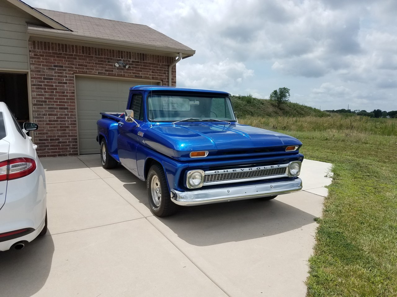

    Honestly I've started driving my 65 so often now my Tacoma feels like a spaceship when I get in it. Even if there was an issue or hesitation I'm not going to be able to perceive it.

    Ha! It can be hard to keep perspective when hanging out on TW, but there is some need for improvement in the programming. No regrets, just some small desires.
    Sweet ride though! Enjoy it!
