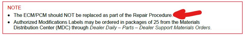

    Holy Hanna! With TSB-0043-020 Rev. 1, it comes with a brand new ( p/n 89661-04L12 ) ECU engine module?? Good grief. Luckily the TSB is good until 80k miles and since I'm only at 6k so far I have time to think about it LOL...

    The firmware update rolls the part number. No hardware is replaced.

    Those are there if there would be a need to order a new ECU. From the supplier, it would come preloaded with 04B42. Flashing the ECU with the TSB creates that new part number.
    NorrinRadd[QUOTED] likes this.

    So then we should really be adding a new label to the module when we do a TSB ourselves, so there is no mismatch between the label and the ECU ID then, I'm assuming? Which means it would be easier to just have the dealer do all TSB updates.

    I don't see a reason. The hood label is just a gov requirement that dealers rarely do. They don't relabel the actual ECU. TIS would likely tell them that there is a superseding part number regardless.
    It is rarely easy to have the dealer do a TSB update, but you can certainly try. This thread is filled with the tears of those that tried.

    I had one done at the dealer and they didn't add the under hood label. Much easier to do yourself. The module reports the correct (updated) part number when interrogated. I wouldn't be surprised if the box level has a different higher level part number printed on it that doesn't roll with the update.
