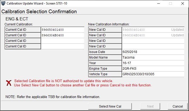

    Am I missing something? '17 with AT. ECU is 04B00. According to chart 04B04 is next update. Updater says it won't work.

    Take a picture and show us what you're seeing. 04B00 is wildly ancient. One of the first and most awful calibrations

    Here go?

    It says you're on 04B04.
    Left column, 2nd row.

    Told you I was missing something! Those last two zeros threw me off! Thanks!
