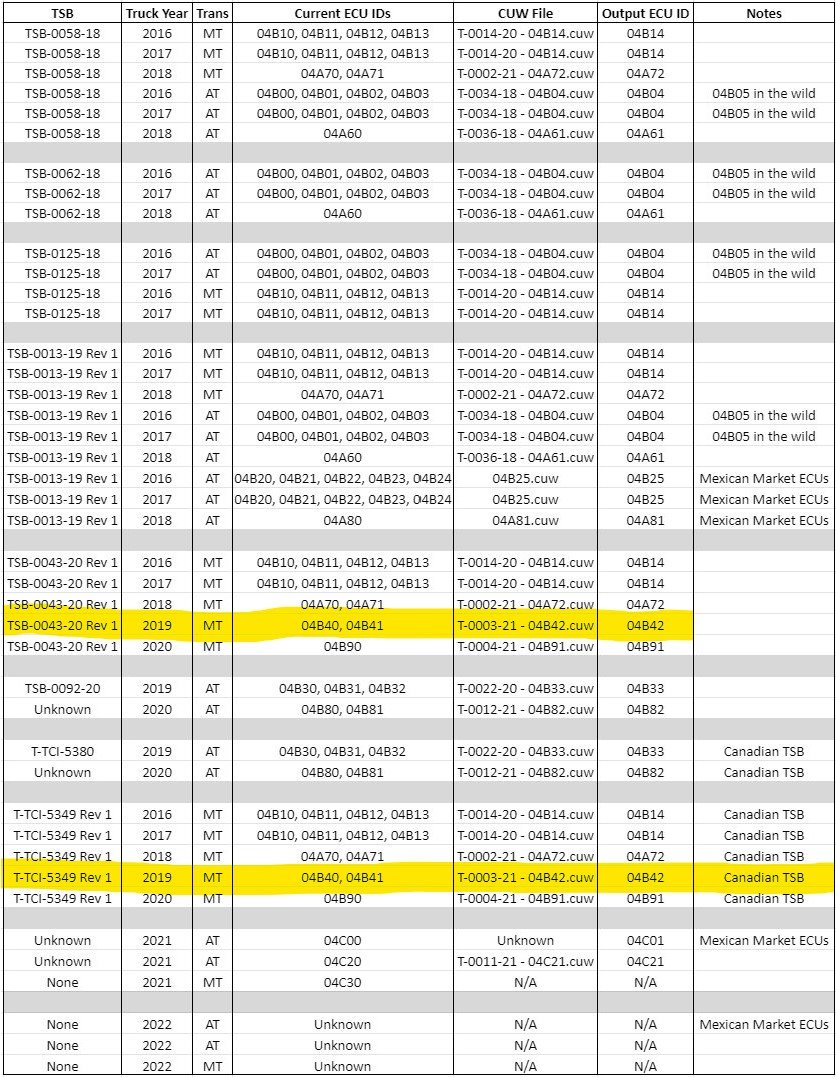

    Looking to clarify something here. I have a 19 MT and am currently on 04B41 and have the Magnuson Kit installed. Looking at the nice spreadsheet that was in the first post it looks like I'm supposed to be on 04B42. It also says it's a TSB for the Canadian market. Is that just because they were updating their trucks after ours? I guess I'm just looking to see why there would be two different updates, for two different markets, but they are the same exact update???
    The second question would be, *should* I be on 04B42 and then contact Magnuson to get a tune for *that* ECU ID?
    I'm still learning this flashing process and what to do in what order, reading, and reading, and reading, and reading again just when I thought I had it figured out. When I flashed the Magnuson tune it was really straightforward and had zero issues, so I know it's ok and will run just fine, but I'm curious to know if updating and flashing the tune for *that* ECU ID may improve things.

    04B42 is the latest update for 2019 MTs. vF does not have tunes for it yet. They will release with 2.0 Ultimate. I believe Maggy created their tunes from Toyota Stock, so they should be able to get you on the latest TSB tune.
    I would not update to 04B42 without a Maggy tune in hand because you will be Stock which is likely to be bad for you.

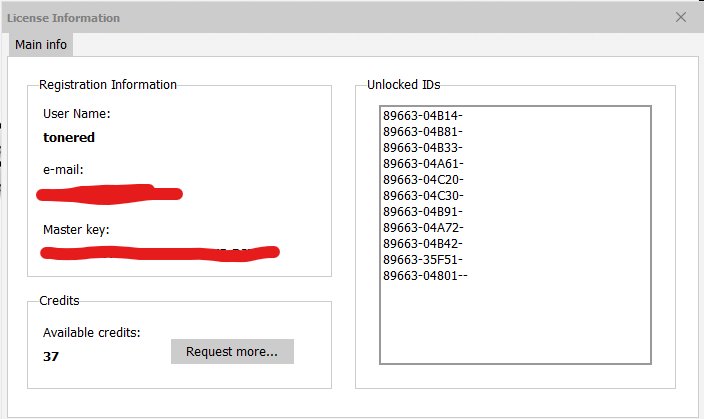

    You do not need to Unlock the 04B42 ECU ID if you are only flashing a tune. If you want to view or edit it, you need to Unlock it. Those are the breaks. I'm in the same jam with more ECUs to worry about.

    The best and current approach is to just do what the vF software tells you to do. If it asks for Credits to Unlock something, then spend some. If it doesn't ask for Credits, you're in the clear. You only need to worry if it is asking you to spend Credits on something that you already Unlocked. Unlocks are permanent:
    -- VIN Unlocks are permanent for any vF user.
    -- ECU ID Unlocks are permanent against the Master Key (license) that Unlocked it.​

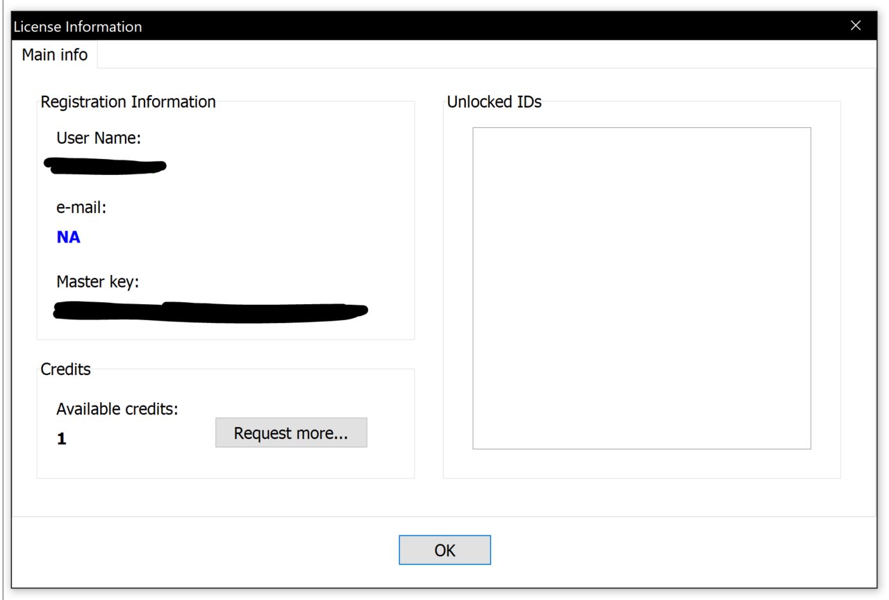

    So I have successfully flashed just the one tune from Magnuson but my list has nothing in it...

    It looks like you did not open the tune file prior to flashing (absolutely nothing wrong with doing this) so it did not use credits to unlock it.

    That is how it should be. The NA for the email address is puzzling though. You may not have a full vF License? Just the Flash Only / Lite License. With that, you will only ever have the original five Credits and should not be able to purchase any more.
    Of course, you can convert to a full vF License. I do not know what that cost difference is.
