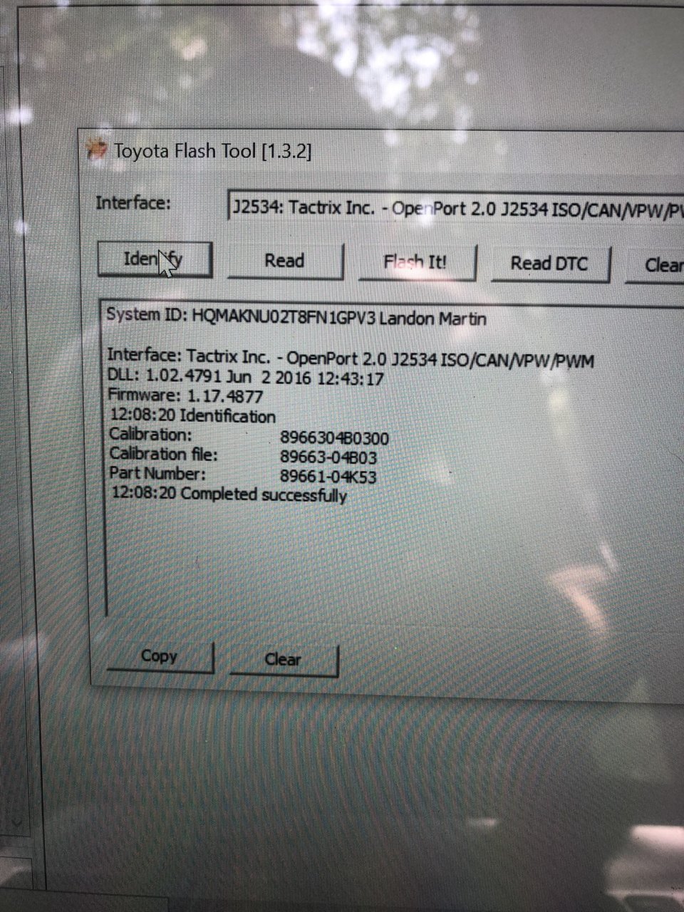

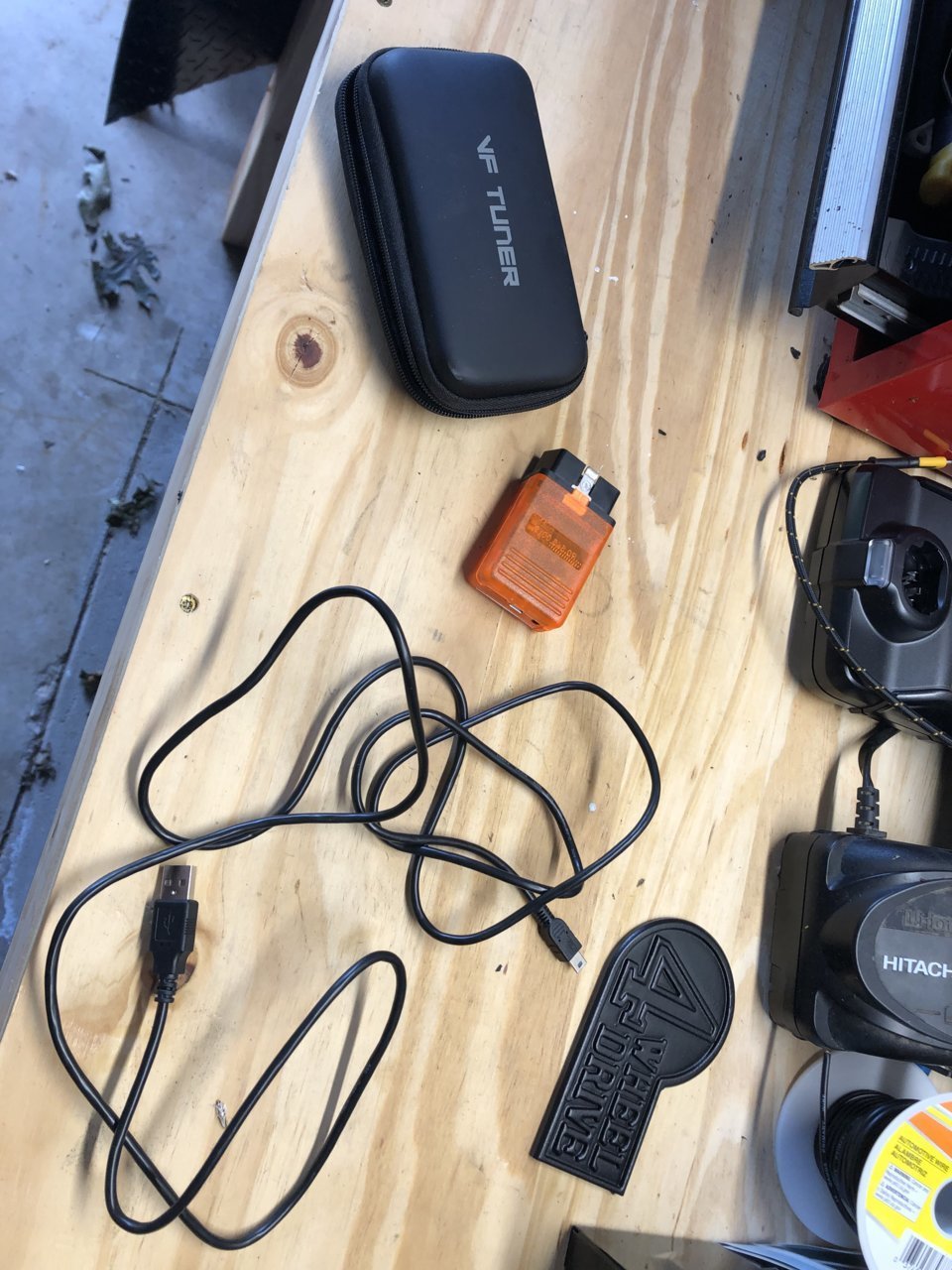

    So I was sent here by TwTaco for instructions on how to load TechStream & the TSB/ECU update CUW files? I'll be honest this is all a foreign language to me haha. I have zero clue what any of that means. Basically I'm on an old vftuner version (which is crazy considering I just paid like $700 for this from OvTune in January) and I guess I need to update to 04B04? TwTaco told me to email Mat at OvTune to let him know I need this upgrade so I did, however I'm sure they don't answer customer support emails on weekends. I noticed a difference when I tuned it myself in January but have added weight, lots of lights, and a 3" lift since then. Heard great things about the KDMax Tune and Chan Tune. Want to try the KDMax first.
    Can anyone explain to me what I need to do? And I mean hold my hand like a damn child and explain it like you're talking to a 5th grader haha. I can personally install 100+ mods to my truck but once computers and tech get involved I'm toast! I tried to be as detailed as possible above but if I left something out let me know! Here's the OvTune connect I have and my calibration identity (I think that's what it's called). Thanks in advance! This is why TW is amazing!

    Iowa
    Everything you need and step by step instructions are in the first post of this thread.
    once you’ve got techstream installed, you just run the cuw file and follow the onscreen instructions. It’s pretty idiot proof
