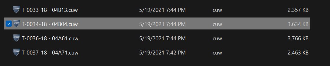

    Something seems to be wrong with the CUW files in post #1. In particular I need to run T-0034-18-04B04. I downloaded the file and unzipped it, but it's showing as a PDF and won't let me open it. Anyone know what I should do?

    @tonered - Hey Tony, you and I have been chatting via PM in vF Tuner. I sent you a message there this evening.
    Yes, I have v16 of TS installed. Earlier I was hooked up to the truck and went to open the file I had saved to my desktop, but it wouldn't open. My PM to you in vF forum has more details.

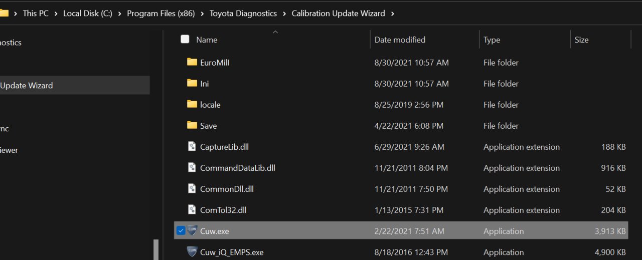

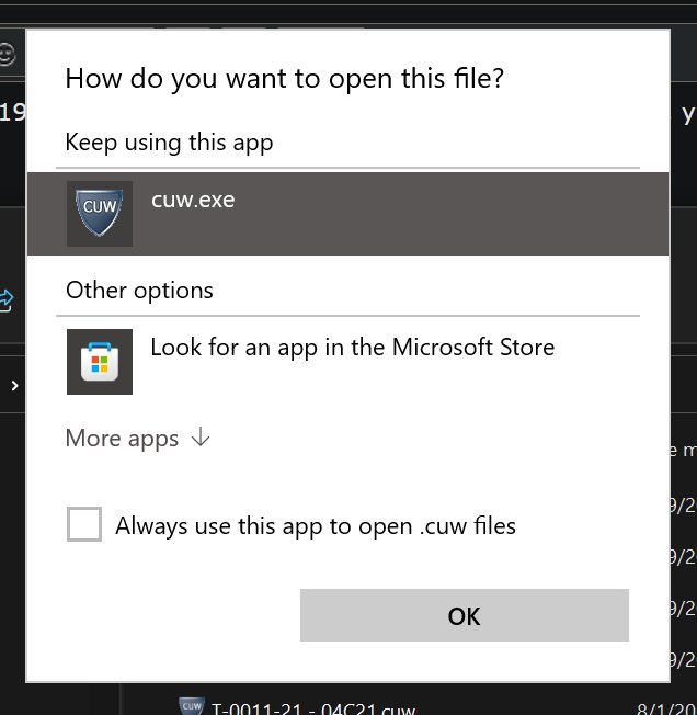

    The CUW file type should be associated with the CUW.exe program. Does yours look like this?

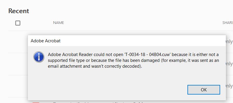

    When I try to open the file from my desktop, it opens up Adobe Acrobat Reader DC, and the below is the message I get:
    Is the CUW.exe program associated with TS, or something separate?

    Yes. You need to point the file association to where I show in the screenshots above. PDF is completely wrong.

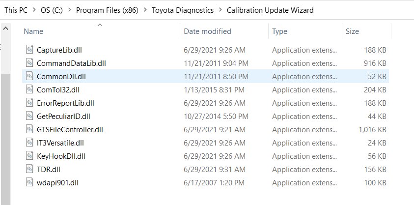

    Something is not right there. You don't have the EXE?
