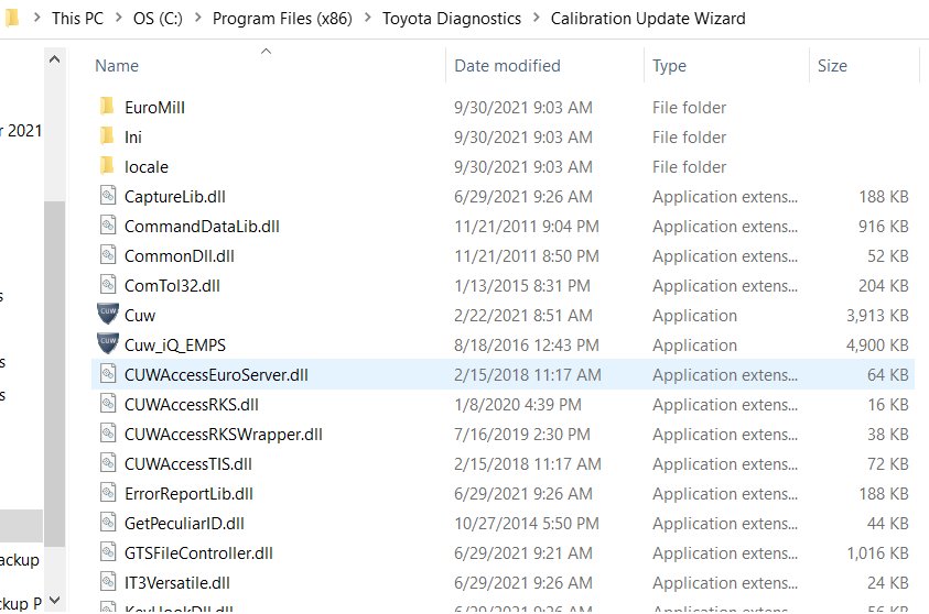

    @tonered - Yep, that's what I was saying. Uninstall the current software, then reinstall, re-activate with a new key, then go into the Calibration Update Wizard folder to ensure that the CUW.exe file is there.
    I already uninstalled and am currently downloading again.

    Yes. That should work.
    You don't need to redownload the TS installer. The a/v cannot hurt that.

    @tonered - OK, I think I am back up and running. I assume those CUW files (Cuw and Cuw_iQ_EMPS) are what I was missing before?

    The file should open the cuw manager. If it does not you'll need to manually assign the .cuw file type to open the manager by opening it's properties page and assigning the "open with" program as the cuw.exe file from earlier. It does not need to be connected to the vehicle to work. But the cuw manager will connect to the vehicle after you click the next button

    Tried opening the CUW file and was able to (cuw is now an option via "open with"). It launched the Wizard! Sweet!

    It should work properly now. All you do is double click the file and follow the wizard. If the file is compatible or not it will tell you in the program. Just follow the screen prompts and make sure you either have a full charged battery or a battery tender so you don't lose power half way through flashing. I didnt have any issues following post 1 on the thread and my truck updated without issue.

    Nothing to do with TS specifically, but I noticed in your screenshot above, you don't have your Windows Explorer file manager set to show extensions, and that might have helped you a lot in this process. In Explorer go to the View tab at top and click the box for File Name Extensions. It will be much better in the future now!
