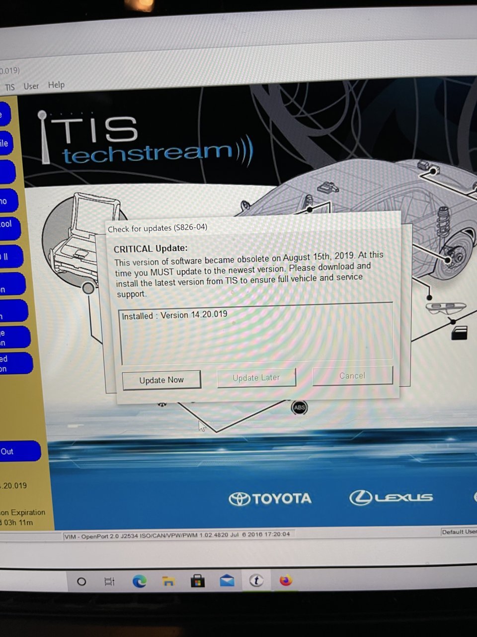

    Ok trying to connect to truck with 14.20.019
    getting critical update and I can not cancel it.
    Suggestions

    Don’t connect to WiFi when using techstream

    See the red text in the 1st Post. Noted twice.
