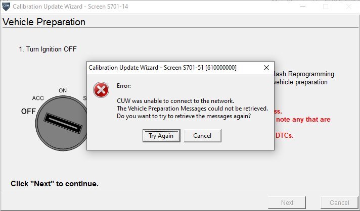

    I got a network connection error message in the beginning, but I just hit cancel… something about needing to retrieve messages. Not sure if that’s covered in the first post. Maybe it is and I missed it.

    Of course it does. See the red text. Turn off the WiFi.

    Yeah, I had the WiFi off so I didn’t get any critical updates needed warnings, but I did get this:
    almost like a warning caused by having the WiFi off, because it’s trying to get messages… only briefly threw me off.

    Just hit Cancel. It is more like Continue for that step.

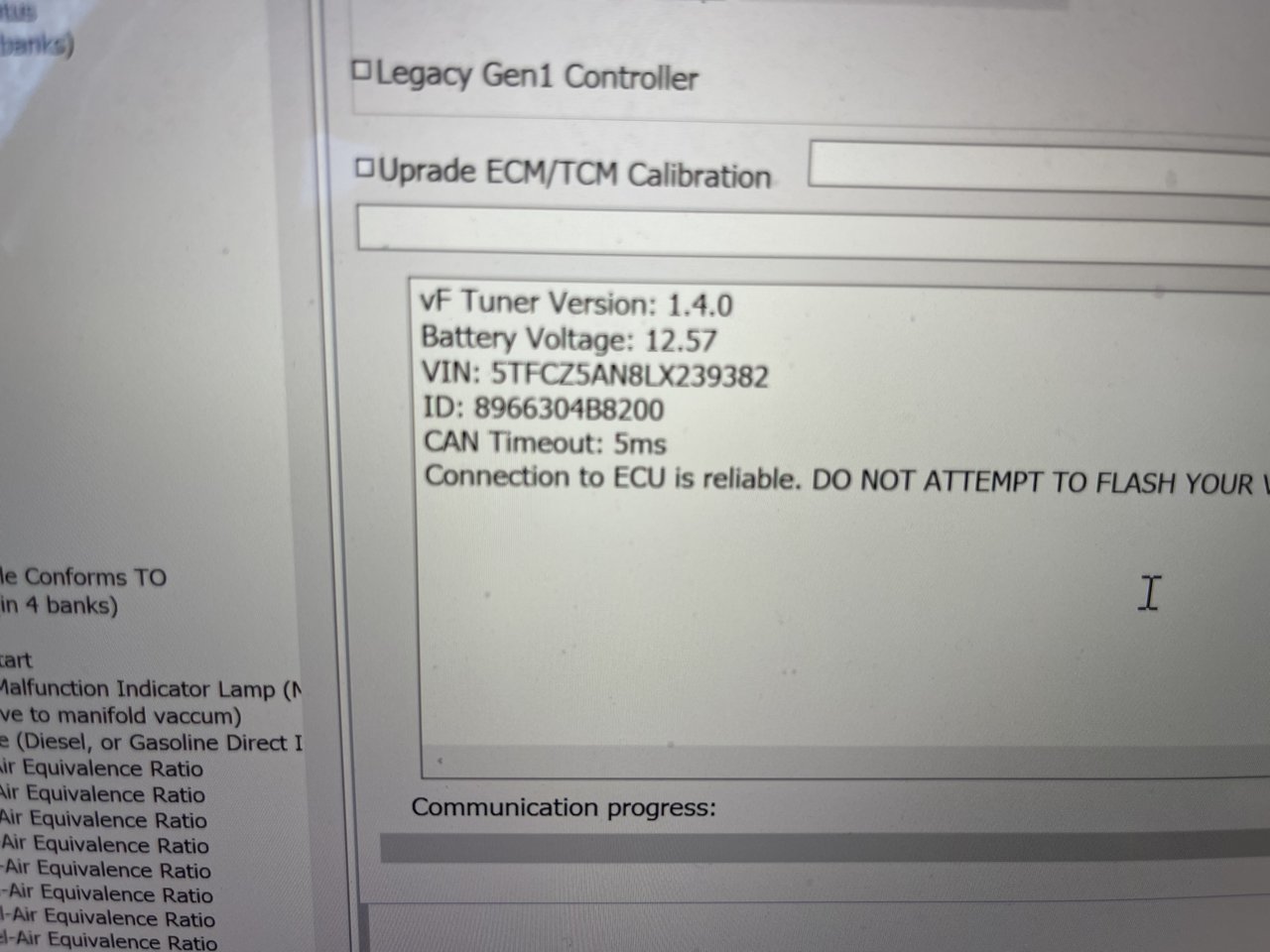

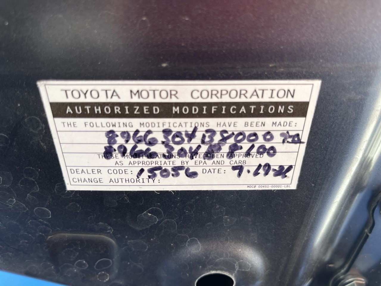

    So was getting ready to flash my 2020 to 04B82 with the latest update myself with tech stream.
    I had to take the truck in to the dealer for a windshield replacement and asked them if the would flash to the latest one. I gave them the TSB etc. and they said no problem we should be able to do that for you.
    when I picked up the truck today the ticket said it was already flashed to the latest.
    My KDMaxx files are for 04B82.
    I guess I can fire up tech stream and try to verify if they actually did the update?

    Click Prepare ECU with Vftuner. It will tell you the ECU ID.

    Well looks like it was in fact the latest. The previous guy that flashed my truck at the dealer must have written the wrong ECU ID on the sticker :(
