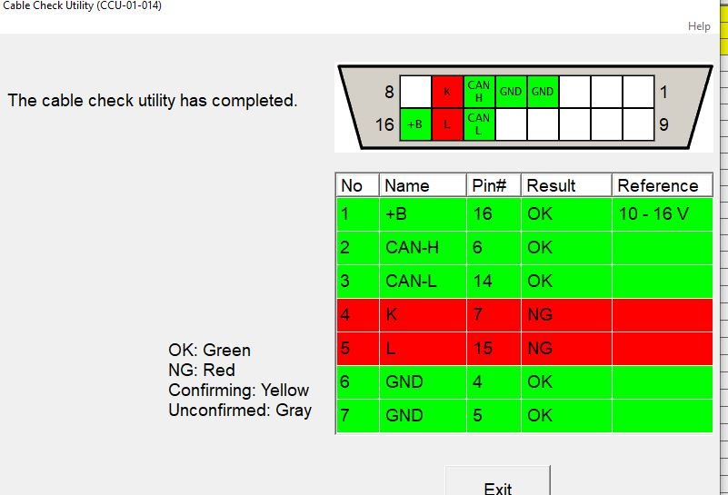

    Is this a normal response for the cable check utility in techstream? I'm not sure what the K and L pins are used for... does Toyota use them?
    I'm running Techstream version 14.20.019 and using a Tatrix cable.
