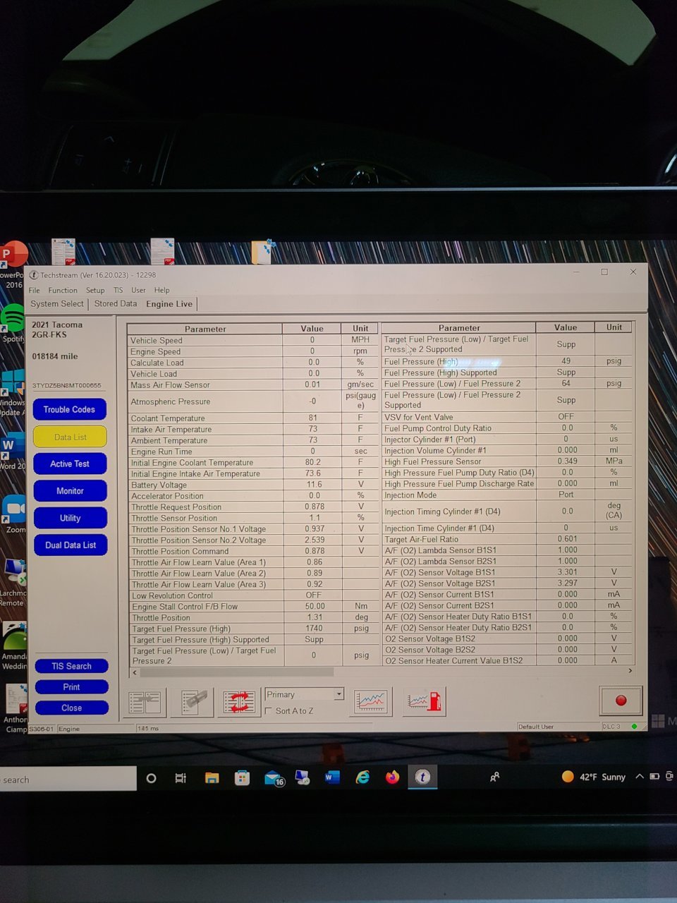

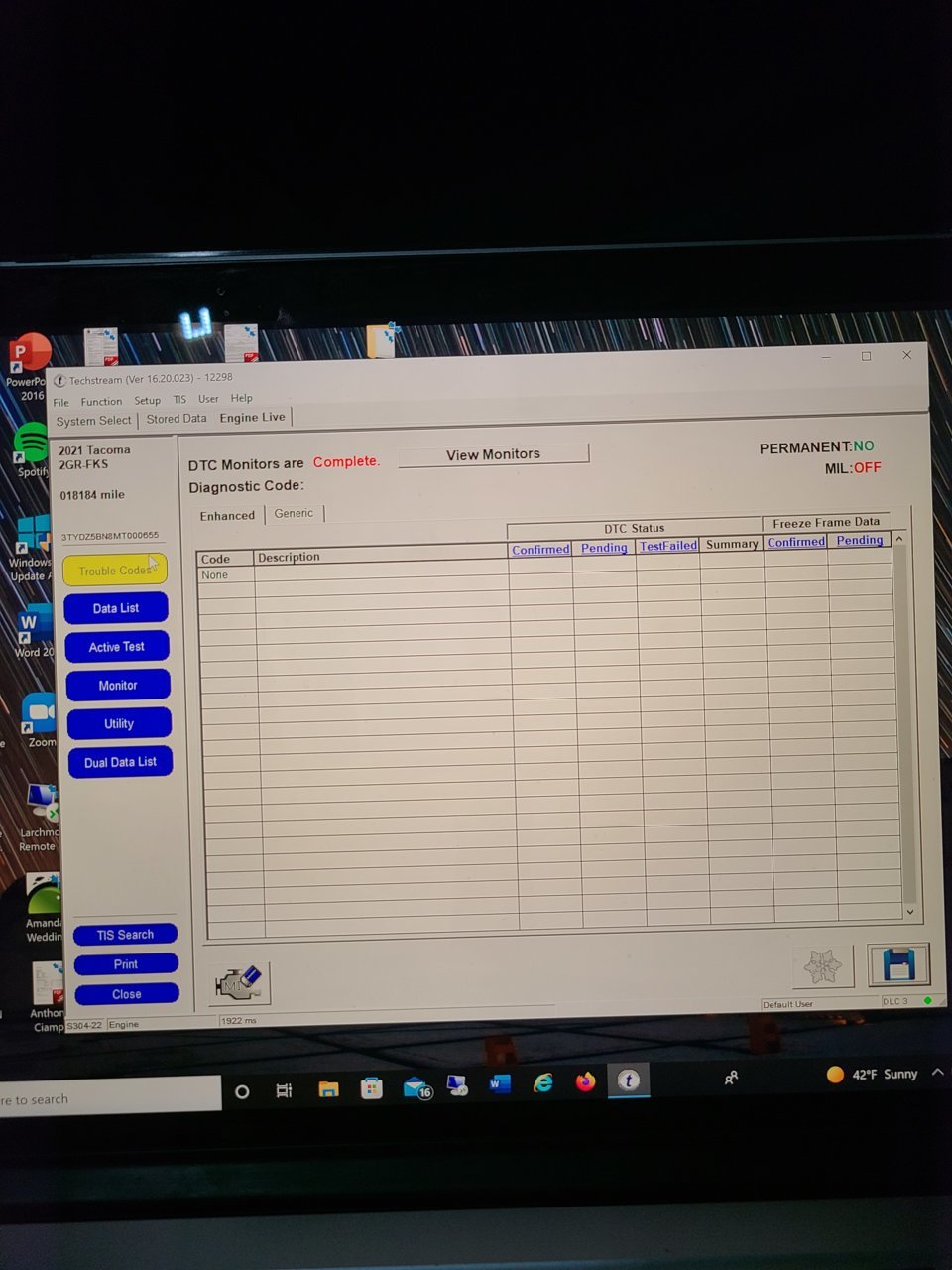

    Sincere thank you to the gentleman who compiled the information in this thread! I've got V16 downloaded and started customizing some settings in TS on my 2021. I've got a few questions though..
    I've clicked engine ECU to try and see the ECU ID and figure out if I have a TSB update available but there's nothing to show here.. Anyone know what I should be clicking on?20220227_205355.jpg 20220227_215310.jpg

    I think the details are in the 1st Post, but click on the Utility, then click Health Check. To save time, only check the power train ECUs. It will pop up the ID there.

    Ran the health check and it came up like you said. Looks like there's a TSB update available for me so now I'm going to add that to the list of chores. I appreciate the response and you taking my suggestion adding it to the first post, I think that will help avoid the same question in the future.
