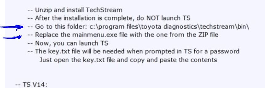

    I dont see the main menu file in the downloaded link that you replace in the BIN folder. Is this a step you need to do for the 5k days to show up?

    If you are talking about the key generator, antivirus programs will immediately delete it if they are not fully off when you open the ZIP file. Redownload it again after turning everything off.
    Yes, though. That program will give you a key to get the 5,000day+ license.

    Referring to these 2 steps shown in post 161

    Iowa
    Those are way old instructions. Follow the ones in the first post

    What @Shellshock said. That stuff is for V12. It won't give you full access on your 2019.
    V14 is in the 1st Post. V16 is there also, which is needed for 2021+. There are costs and waiting associated with that version though.
