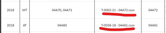

    If your AT or MT, this is all that you need to worry about:
    The many TSBs cover the same Tacos with the same update, just note different symptoms for the dealers to reference.

    257
    18 cement
    That's what I thought until I read it again. That is weird

    Lynnwood, WA
    No worries. It is a lot of info to digest.
