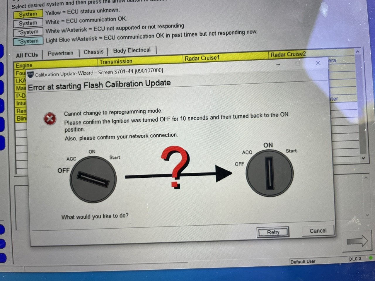

  15. May 16, 2022 at 11:10 AM
    #5455
    GmanCement18
    GmanCement18 Member
    Dec 10, 2018
    #275442
    16
    AZ
    18 Cement TRD-OR DBCB LB
    Method 17" rims w/ Nitto Trail Grappler, Icon billet UCA, 2.5 King shocks w/ reservoir, Deaver 700-1000lb spring set, King Hydrobumps, long range America 32 gal tank, full CBI aluminum skids, RCI sliders, Go Fast Camper, Batwing awning, domestic fridge, a slew of Baja design lights around the vehicle, sPod control unit, dual battery set-up, Victron solar controller, Victron shunt battery monitor, pressurized water system, 15lb Powertank, Anytime camera, Magnuson Supercharger
    Definitely gonna need some help from the community.
    In attempting to update the CUW file 04A61 for 2018 model year I’m getting this pop-up (1st image)also closed the TechStream software and ran only the CUW file and no matter if I follow the prompts it doesn’t proceed beyond. Additionally the info dash showed up with a message about ‘vehicle brake and to visit dealer’ upon starting the vehicle it appears to be in limp mode. Idles up and down and gas pedal doesn’t do anything.
    Waited a few minutes and it starts fine and no messages on the info dash.
    What the fuck did I do?
    Had previously flashed a Magnuson update in March/2022 with no issues at all. That file was (2nd image) done through VFTuner.
    There is a great deal of pages in this thread so apologize if this has been a previously solved problem.
  16. May 16, 2022 at 11:20 AM
    #5456
    tonered
    tonered [OP] bartheloni
    Sep 25, 2017
    #231055
    31,238
    tony
    Lynnwood, WA
    Weird!
    You flashed the update by launching the CUW file, not from within TS?
    You're engine is off when you flash right. Ignition On, Engine off.
    If you flashed successfully and are getting those issues, then something is up. Did you flash the new Magnuson tune over top of the ECU Update? The ECU Update puts you on a stock tune with a new ECU ID. You went from 04A60 to 04A61, right? If so, you need the 04A61 tune from Magnuson.
    Depending on where you are at, @mavrick6382 is in AZ and might be able to help if things are not solvable.
    MPL Ops and GmanCement18[QUOTED] like this.
  17. May 16, 2022 at 11:21 AM
    #5457
    PapaRee
    PapaRee Pro Tuner
    Oct 31, 2015
    #168275
    3,250
    Kreg
    Prairieville, Louisiana
    2016 Black TRD Sport, Tuned, BHLM OEM LEDs
    GTS Dobinson's lift, 33"-Wildpeak Atw3-18x9 -6 Offset ,265/70/18 tires, Raceline Assault wheels, Backflip G2 bed cover, Magnaflow exhaust, Pro tail lights, Pro fog lights, Pro grille, Raptor grille lights, Predator side steps, RedLine Hood Struts, Toyota bedmat, tinted windows, Retrofitted-BHLM-Amber Halo-Amber DRL-HID headlights, LED Highbeams, LED Hood Scoop lightbar, LED hidden bumper lightbar, LED under hood light, LED Bed lights, LED license plate lights, Tacoma tailgate 3d letters, Tacoma glovebox 3D letters, removed air dam, Custom TRD Sport emblems, Pro Shift Knob with Meso ECT Stealth button, Meso LED dome and map lights, Meso V3 smoked mirror turn signals, Meso Stage 2 Tail lights, Meso Mirror Puddle lights, Meso KC-5 Brake/Cargo light, Meso center console bucket with OG lid, Tailgate PNP kit, Garage door opener button in overhead console, Meso Minimalist keyfobs, Matte black Pro hood decal, KTJO4x4 Led door handle LED lights, Pioneer 6x9 3 way front speakers, Rockford Fosgate 6.75' rear speakers, TacoTunes tweeters, AJT black vent rings, JDM Gas cap cover.
    You are going to have to use vftuner first to flash to a stock tune, then do the TSB update.
    Here is @mziggy’s post about it.
  18. May 16, 2022 at 11:28 AM
    #5458
    GmanCement18
    GmanCement18 Member
    Dec 10, 2018
    #275442
    16
    AZ
    I hadn’t got to the tune for Maggy yet as I was attempting to complete the TSB update with the CUW as instructed. I believe the issue is as @PapaRee stated so I’ll put the stock tune back to factory and give the CUW file a go again to see if that does the trick.
    Man y’all are great for being so quick with responses. I’ll post what comes of this. Thanks gents.
    edit: a few hours later and the help of @tonered and boom the ECU is up to date. Took collective 6 min for both processes. :hattip:Now I wait on maggy and YW tunes. This was great and your collective knowledge made this possible.
    ktbell444, MPL Ops, mZiggy and 3 others like this.
