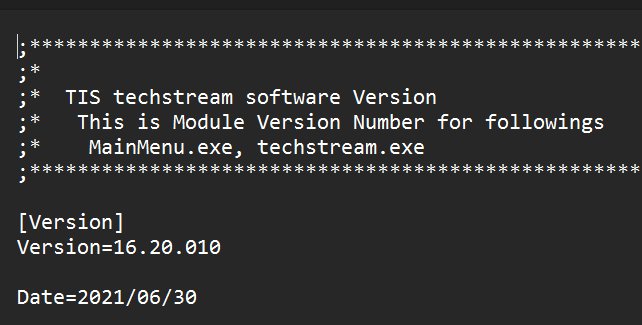

    If somebody with version 16 could post the version information found here:
    C:\Program Files (x86)\Toyota Diagnostics\Techstream\bin\VerApp.ini
    I could try doing the dummy solution and see if the program will just believe that version 14 is version 16 and stop checking.
    My version 14 ini reads as follows:
    [Version]
    Version=14.20.008
    Date=2019/06/25
    If that's the only place the version check looks then it might actually shut it up if we replace it with the version 16 full version and date???? I've seen crazier hacks for sure.
    tonered[QUOTED][OP] likes this.
  9. May 19, 2022 at 12:10 PM
    #5469
    tonered
    tonered [OP] bartheloni
    Sep 25, 2017
    #231055
    31,173
    tony
    Lynnwood, WA
    This is what I have:
