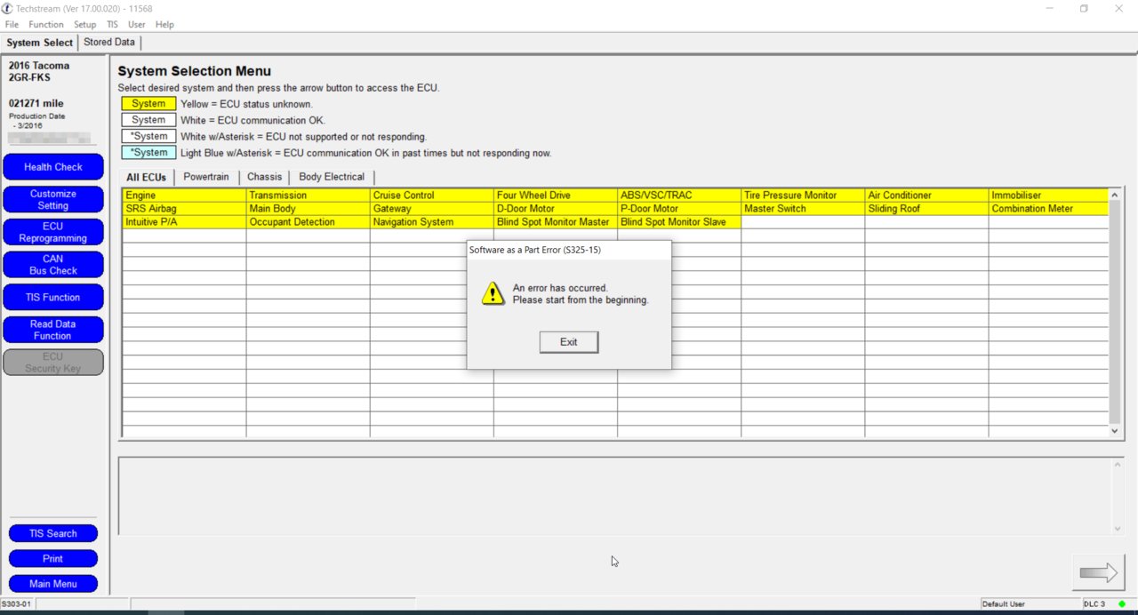

    So a couple of things. First of all, I've attached the screenshot. It occurs when I do a Health Check, Powertrain ECU only. It reads 4 of 4 and then shows the error. If I click on Exit, it then does display the data from the health check.
    My next question is about me using my VFTuner credits to license my VIN number. After I did the Prepare ECM, I clicked on the Read P5 ECM (since it said that Tacoma's used that in the installation instructions). It then told me "This ECU cannot be read through OBD."
    Is that normal at this stage? I have not bought my tune yet, but will be probably early next week.

    That error looks oddly familiar. I seem to recall seeing it myself? I would certainly not worry about it.
    Yeah, don't do that Read ECM step. The only time that you need to use the Read function is if you find an ECU that is not supported by vF.
    Just do Prepare, pay the four Credits, Select Calibration File, and Calibrate ECM. Follow the prompts. After cycling the ignition, consider doing the Learned Value Resets:

    I recently started getting this on 16.023. I've just ignored it because finding a solution was taking longer than ignoring it.
