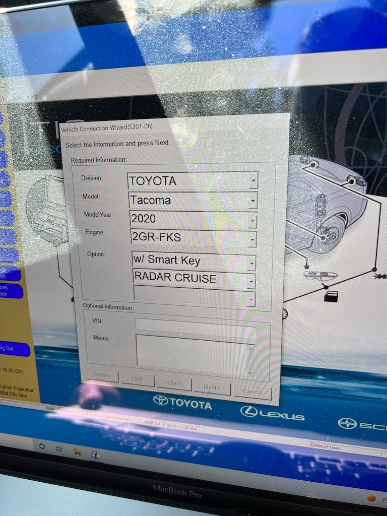

    Tech Stream can connect to the truck but only if I tell it what kind of vehicle it is. All the drop downs except the last two, typically auto populate. This time I had to select them all. I ran a Health Check but I can't attach a *.TSE file. Doesn't show the ECU read/calibration anywhere, just other stuff. Also Tech Stream is unable to read the VIN as it typically does upon connecting.

    That difference is a bummer. I have had to fill in all the info on a few Tacos, but none were ever a problem.

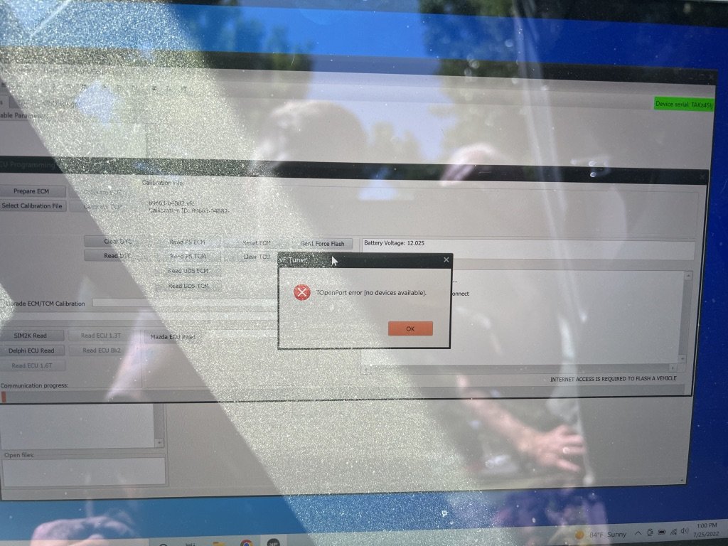

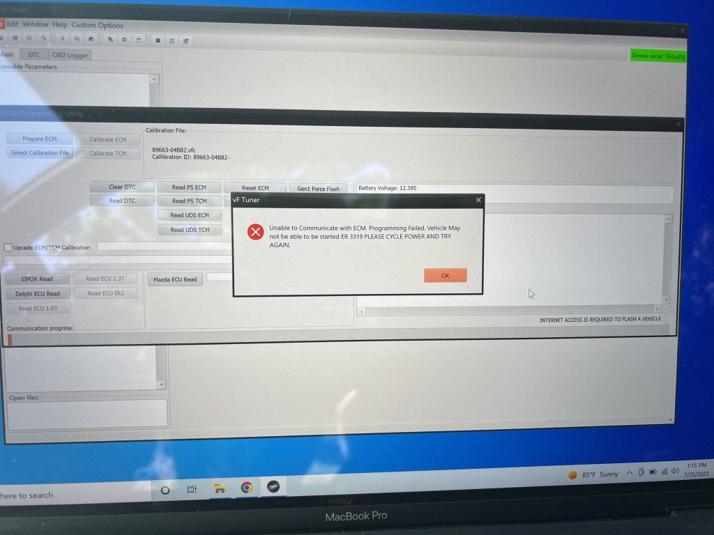

    No Joy. After vfTuners failed attempt at Force Flash Gen 2, subsequent attempts can not be made without restarting vfTuner because doing so throws the following message:
    So that means
    turning off the truck
    turning on the truck to IG no engine
    start techstream, connect
    close techstream
    start vfTuner, attempt force flash gen 2, fail with the following message:
    Times 6, no joy.
    tonered[OP] likes this.
  19. Jul 25, 2022 at 12:50 PM
    #5619
    tonered
    tonered [OP] bartheloni
    Sep 25, 2017
    #231055
    31,339
    tony
    Lynnwood, WA
    I get that message at times. Disconnect and restart everything including the computer.
  20. Jul 25, 2022 at 12:52 PM
    #5620
    mZiggy
    mZiggy Honey badger
    Apr 8, 2017
    #215707
    4,709
    Marc
    2020 MGM Tundra SR5; 2020 4R TRD Pro; 2008 4R SR5 v8
    Have you tried hitting Prepare ECM for normal.flash following opening and closing Techstream? Just on a whim
