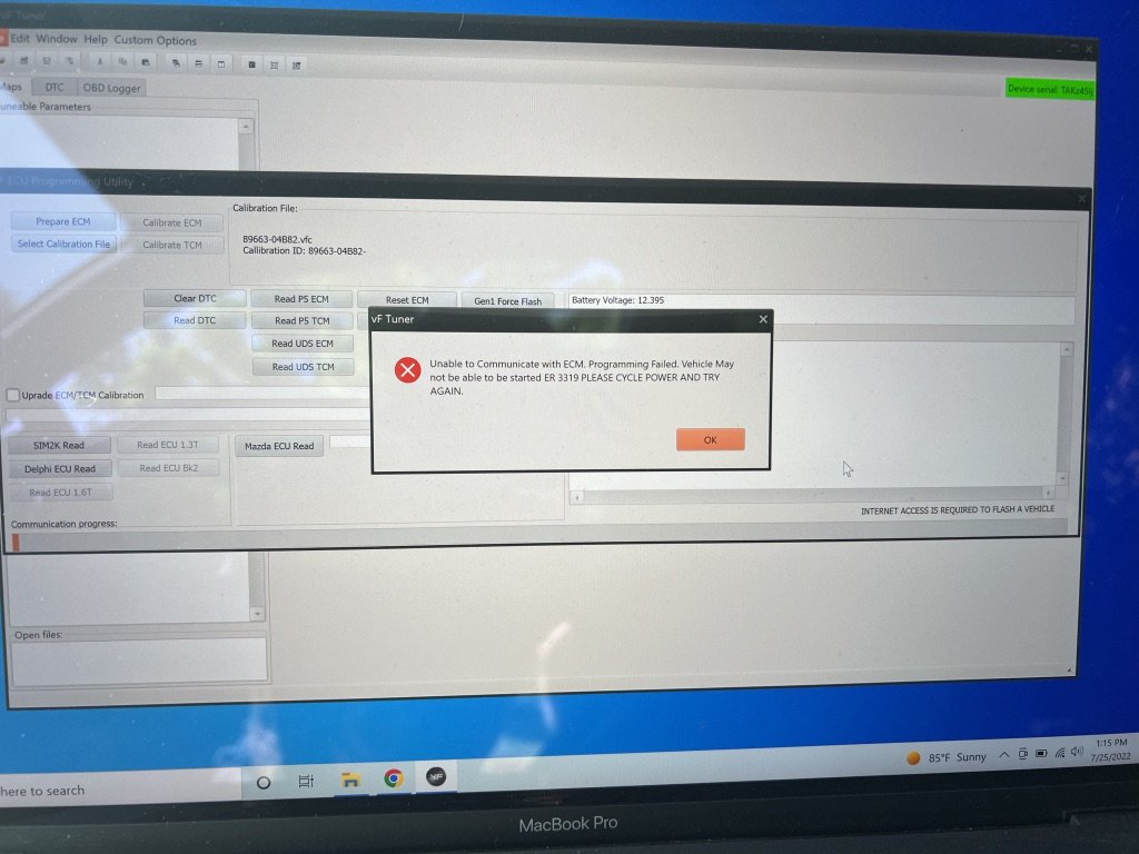

    I tried that several times yesterday. No program can read the current ECU Calibration ID. When any program attempts to, the program throws an error saying there is no communication with the ECU. I believe a bench reset is the only thing that will fix my issue now. Where do I find instructions on removing the ECU? I see where its generally located but I don't know which panels need to come out to get to it.

    Does anyone around the Denver area already have an ECU bench setup working?

    See the 2LM instructions. It gets you into the same area.
    https://www.tacomaworld.com/threads...-2wd-low-range-for-the-3rd-gen-tacoma.614743/

    The YotaWerx tune guide supplement includes instructions regarding the location behind the glove box.

    I’m around for a bench flash. If you can bring me your ECU I’ll do it for free. Hope you get things taken care of soon. And thanks @BortisYeltzen for calling this to my attention.

    Below is a video showing how to remove your ECU by Dave (@dave82at) at Yota Tune in Canada.
    https://www.youtube.com/watch?v=V0LdhmlkhPY
    Get your ECU out and take it to @MGMSangTaco and see what can be done.
    Good Luck!

    Thanks everyone. I'll get the ECU out today. I am really curious now what will happen if we try to force flash the Stryker tune file. I did get the newer Magnuson 04B82 tune from Ryan yesterday as well. I will DM with @Chadr7858 and @MGMSangTaco and will go from there.
