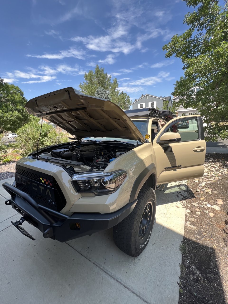

    Progress is to the 1:33 mark, thus far. I got the airbag out, just working on the glovebox screws around the perimeter next.
    For the love of god, please tell me all the ECU module and 4x4 module plugs only fit in one place? You have to unplug everything to remove the ECU.

    The ECU is out. @MGMSangTaco is coming over to help this morning. Stand by!

    04B82 is on the ECU, truck is running

    *Disclaimer: I still have yet to brick a truck in my time tuning and came solely to help a nice TW member that had unfortunately had a brick/aid in the bench flash process.
    Tried stryker now and bricked again. Was connected to constant 13.5v so power was all good. Pulling ECU again for another bench flash then gonna flash the maggy for now.
    Moments after the expensive paperweight came back to life lol
