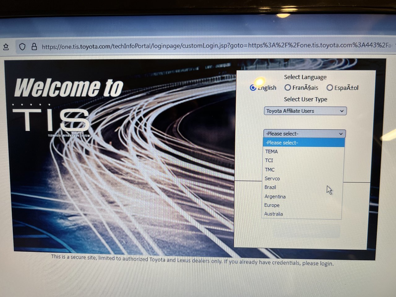

    When I click on update it welcomes me to TIS and has drop down windows for USER TYPE and what looks to be AREA but there's not a North America choice. Are these choices critical?

    That is exactly it. V14 cannot do diagnostics or customizations on 2021s and newer. That might be 2022? I can't remember.

    Yes. NA is what you want.

    Traverse City, Michigan
    But there isn't a North America option.
    EDIT: ah you get different choices in the drop down list depending on what USER TYPE you choose.

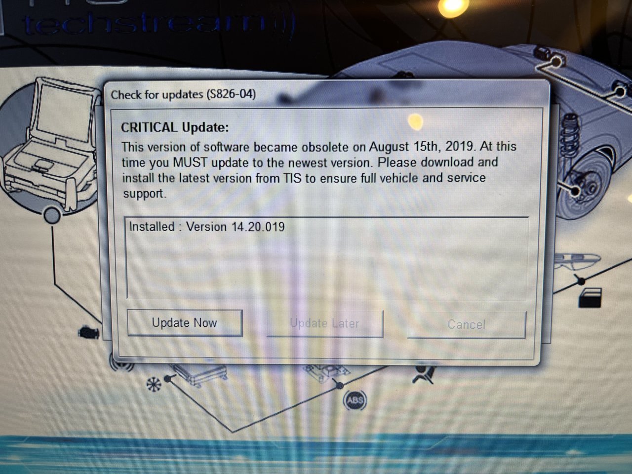

    How did you get there? TIS is the online component that we do not want to mess with. TS, as posted here, is intended for Offline Use only.

    That's what I was afraid of! LOL
    After installation I clicked on CONNECT TO VEHICLE and this window popped up.
    EDIT: But when I update my ECU I double click on the .cuw file WITHOUT opening TechStream correct? Maybe this isn't an issue then eh?

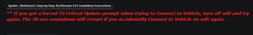

    Yes. At this point, you need to hit Update Now, then close the browser that pops up.
    From there, turn of wifi and try again:

    Randy
    Oh crap, sorry again man. ANOTHER red sentence!
    The quantity of beer I owe you is increasing by the minute!
