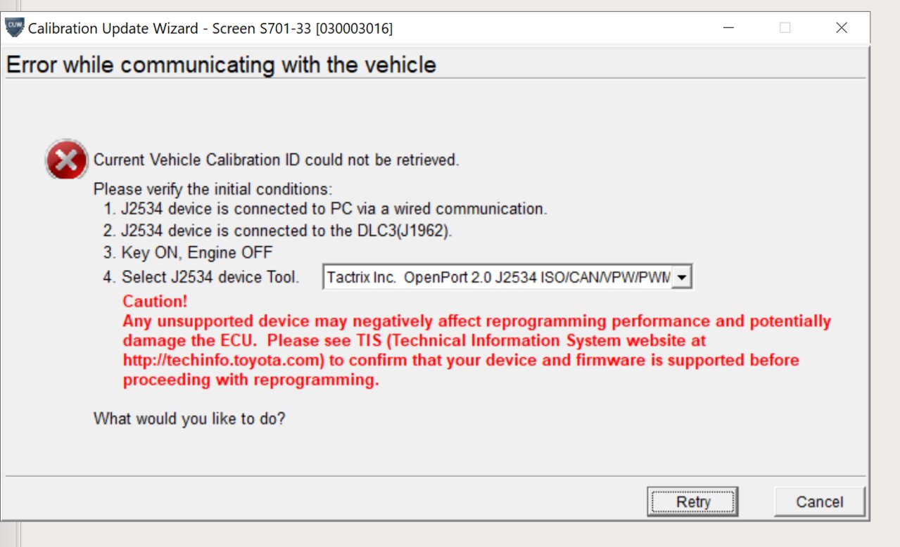

    Was updating my ECU from 04B31 to 04B33 to swap tunes and my computer crashed while it was updating...
    Now TS refuses to talk to the ECU:

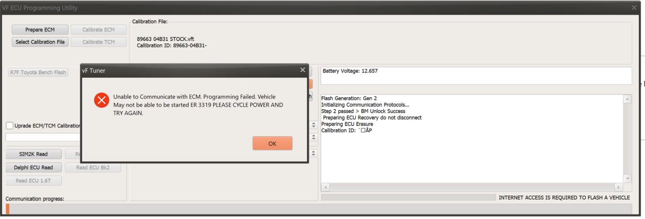

    308846269_1338487776896647_9084447194217_2cbc2505b0d951f4a50b775d352e97be30a3719d.jpg
    and a recovery(force) flash via vF also fails...
    313994647_580368933855935_54391198700339_243d936553b571e3a41b741fa19772670ea63665.jpg
    Anything else I should try before ripping out the ECU and finding someone to bench flash it for me?
    Note: Running a health check via TS shows all yellow issues. vF is able to unlock the ecu and get it to respond a bit but then errors out with the above.

    If the ID you attempt to flash is wrong (according to the ECU), the vF flash window has to be closed then reopened or else each attempt will continue to fail. I'm not sure why that is the case but definitely slowed me down a few months back.
    So if you were B31 and you were in the process of updating to B33, then attempt force/recover with B31 (which it appears you did try). If it does not work, then close out the flash window (not vF, just the "VF ECU Programming Utility" window), reopen the flash window and attempt force/recover with B33.

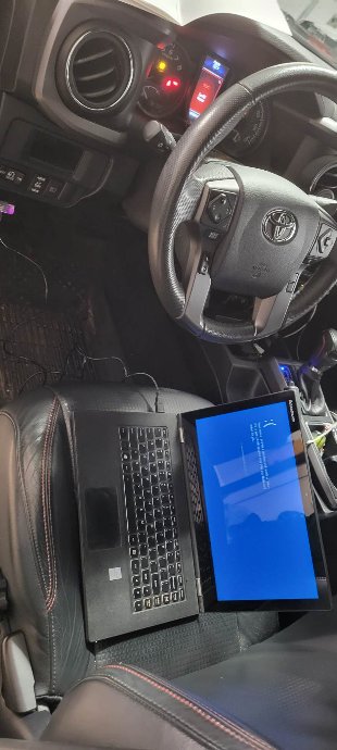

    Well that was a fun adventure...
    310499823_673697904334828_22174135311333_80922efc100a368d8884fcf4338a62a62243dbaa.jpg
    I'll do a quick write-up of how I got it to recover tomorrow. Thank you guys for the help.

    I then went back into TS to try to flash the 04B33 file and it failed with a calibration mismatch.

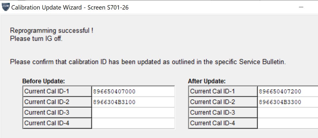

    313781286_645442423728039_70108202253192_cd3c77e73e071293c45c3a7552969860f6c5a019.jpg
    If you look at Current Calibration ID(2) you can see why. (Looking back in this thread I think this is due to maggy flashing the erom but smarter guys than me can answer for sure)
    312705892_1492928904504541_5732949580989_d9a8e86b3f07123381d3e7e0b42bc3f3df2f804c.jpg
    Cool, I'll just try flashing back to the stock file... But it failed. After fussing with things a bit I ended up adding back in the inline fuse for the coolant pump and was able to force flash the stock 04B31 file.
    I then hopped back into TS and tried to update once more. This indeed fixed the Network issue in the screenshot above but now complained about the voltage even though it was reporting seeing 13+ V at all times but would see small dips as the coolant pump kicked on and off.
    I once again removed the inline fuse for the pump then the update via TS ran no problem.
    Lastly, I tried to flash the new maggy tune both the normal way and using the force flash and received an error identical to my previous post(ER 3319).
