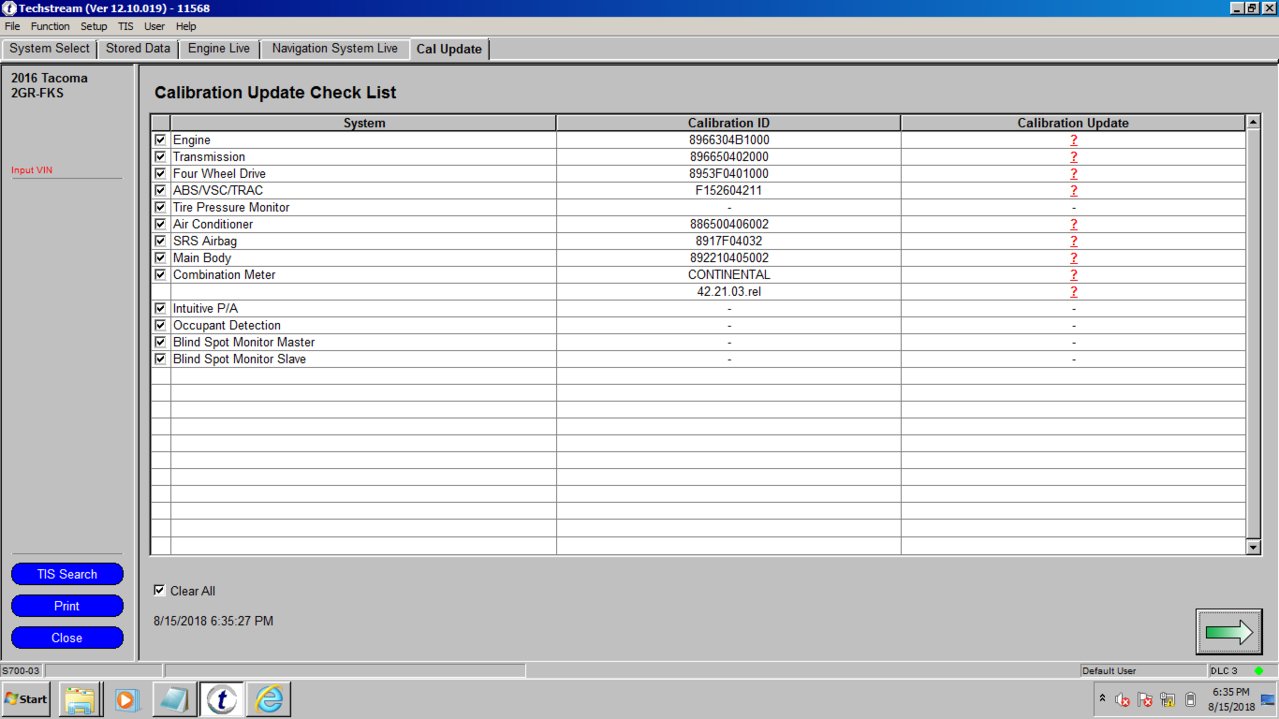

    I'll post a pic of the calibration ID on the first post but your SOL on the work order. There wasn't one because as a tech I don't need to generate one. Decided it was to much of a pain in the ass to ask a service advisor to open a work order. :D

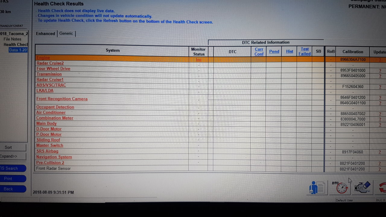

    Yeah in OBD fusion you select "Diagnostics" on the main screen, then choose the "Report" icon at the bottom. The list that comes up includes "Vehicle Information (Mode $09)". Select that and your call ID should come up. Of course, you need to be connected to the dongle first and the ignition must be on.

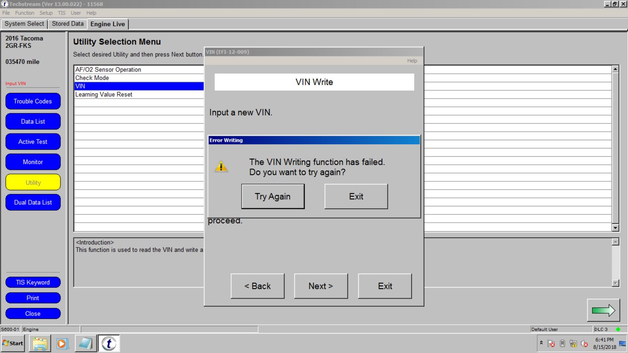

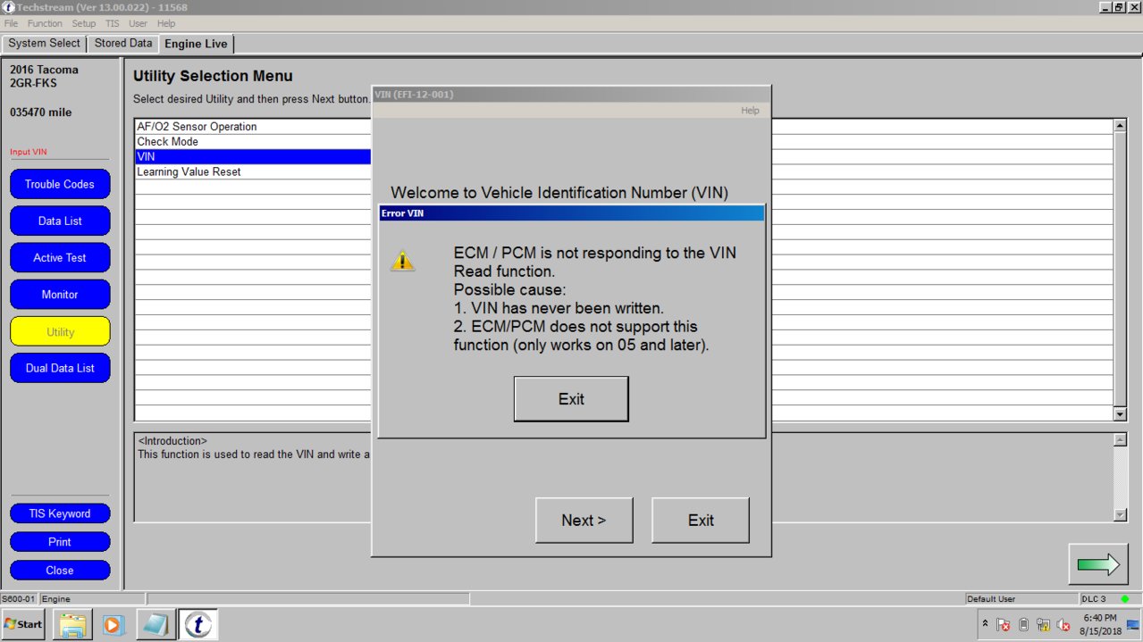

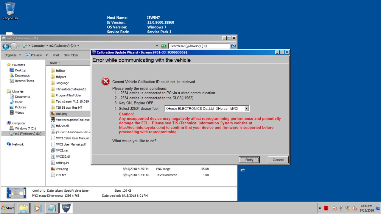

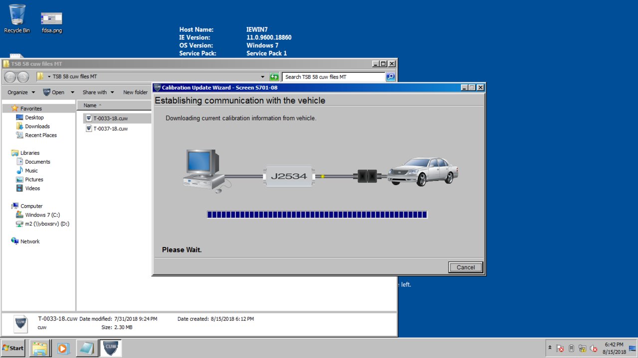

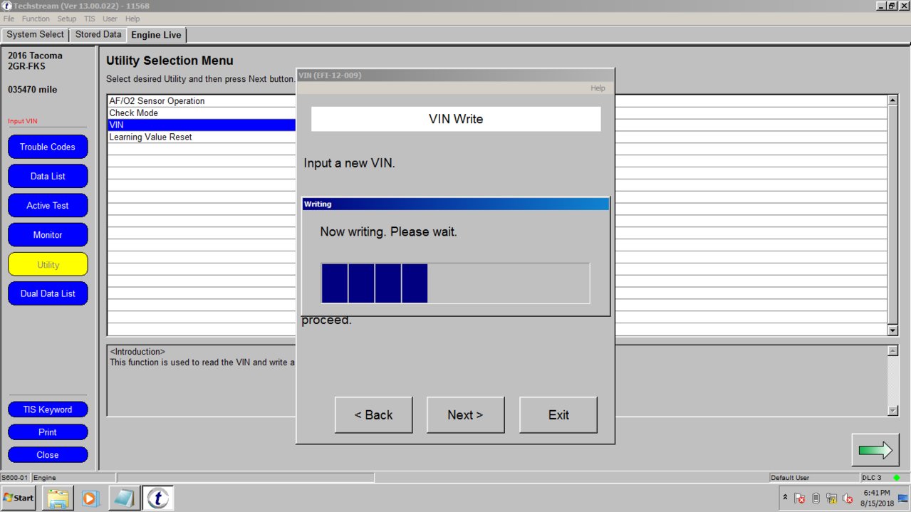

    Hello all,
    I have this Mini-VIC j2534 that I use to change settings on my trunk but I cannot flash this update to the ECU. Attached is the errors I have having when trying to add the VIN or flash.
    This is what I get when I try to add the VIN
    when I try to see the VIN
    This is what happens when I try to flash
    My current build
    Not sure if anything could give me some pointers or help me out. Neetheless i'm out of warranty, so getting the dealership to help is all most out of question.

    Mini VCI adapter lets you customize a few things but not fully flash the ECU.
    You'll need a Tactrix adapter $169 https://www.tactrix.com/index.php?p...m_virtuemart&Itemid=53&redirected=1&Itemid=53
    or a Mongoose adapter like the dealers use for $495 here http://www.drewtech.com/mongoose/toyota2.html
    I know the Chinese made some knock off tactrix openport for 1/10th the price of the real one, but who knows what kind of problems you may run into later. Why don't you support the real American made Tactrix adapter made right in San Francisco, they ship Fedex fast.

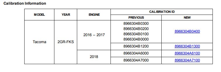

    ^ here's what he means by it's in the TSB. 8966304B1200 and 8966304A7000 are MT ECUs

    It an attachment to the post that @SContiVT quoted, the first post in this thread.
