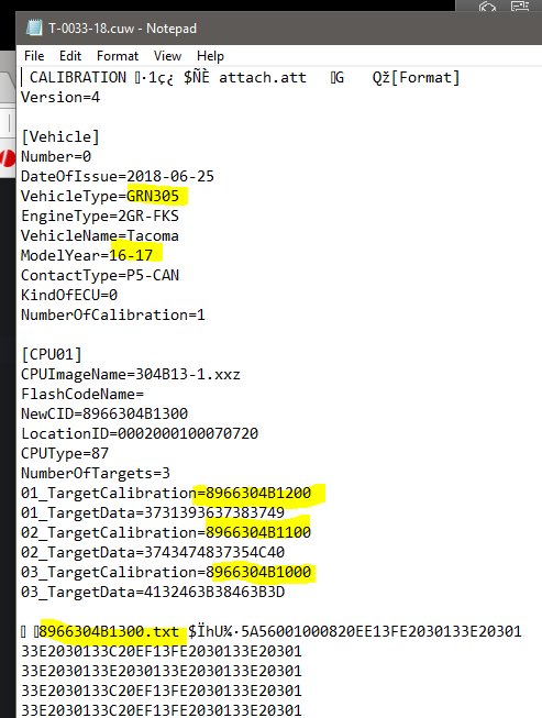

    Here's a fun one. I opened 33-18.cuw in Notepad:
    All kinds of good info there, along with why it is working on 04B10 and 04B11 ECUs.
    So, that's how many errors in the TSB?

    Modified the level of gas in the tank
    Means the "documentation" dept at Toyota totally fucked up the only job they has...accuracy. it's in that file that this covers MT also. It's basically a manifest of the payload of the TSB Update. Except the official Toyota documentation of this TSB does not reflect the manifest, or the payload.

    Lynnwood, WA
    Mainly that the TSB files address all MTs, as we found out, but the TSB only list 04B12 for the 2017s.
