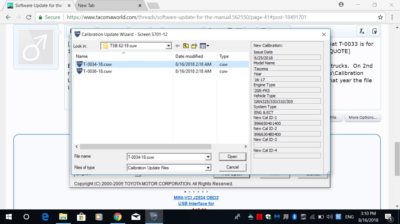

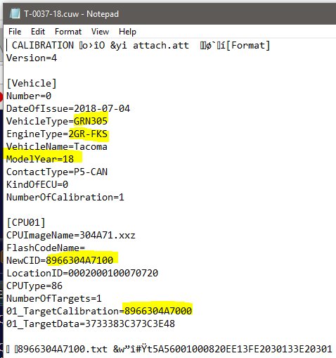

    Sorry that this didn't work out. This won't technically help at your dealer since they tried, but there certainly is an update for the 2018 MTs.
    You can see the MY below. Your ECU is 04A70. The update will make it 04A71.
