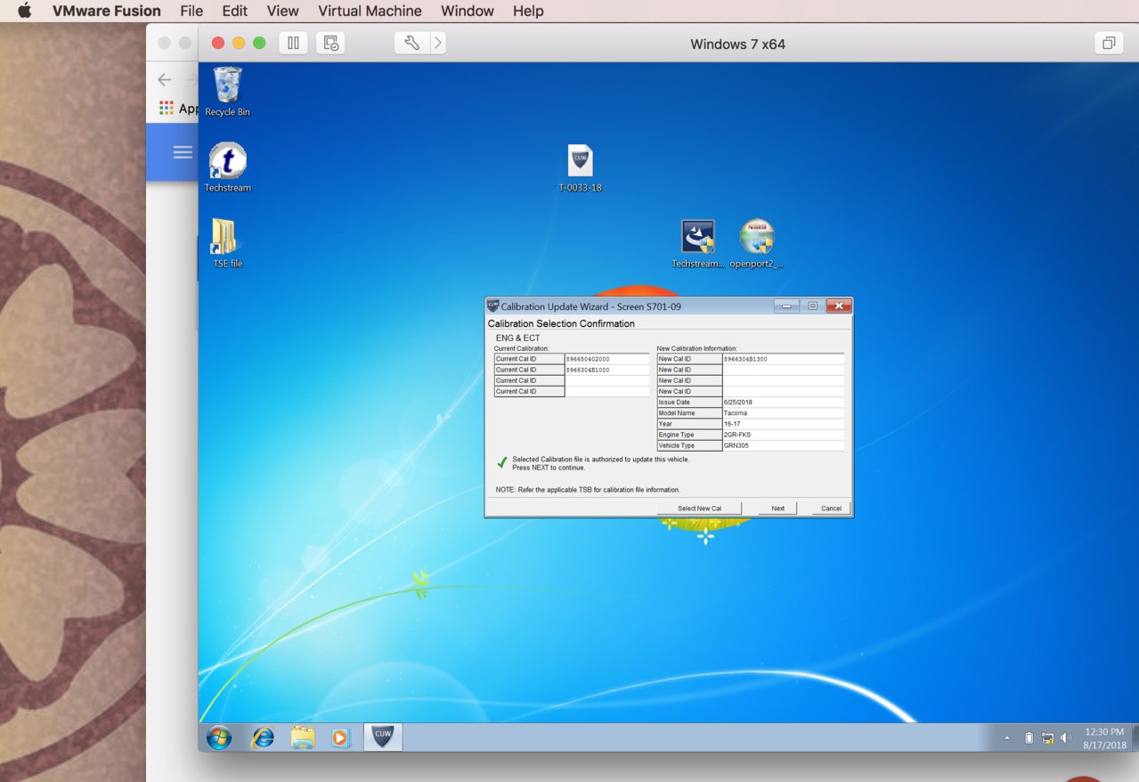

    Flashed 2 minutes after my cable arrived :)
    VMWare fusion running Windows 7 for those asking about running from a VM (virtual machine). Just need to plug in the tactrix first and pass through the USB device.
    su.b.rat, mstrbrc and tonered[OP] like this.

    I don't have an old computer, does the techstream listed by OVT work with win10?

    The TS version that @mstrbrc linked in Post 571 to obdii365.com loaded on our old laptop running Win10 without a problem. His cable just arrived in my mailbox and I will be test driving it as soon as I get home.

    I have it installed on Win10, and it appears to be working just fine. I haven't attempted the upgrade yet, but I don't see any reason why it wouldn't work.
    Program runs, Tactrix cable drivers installed, and I can connect to the truck.
