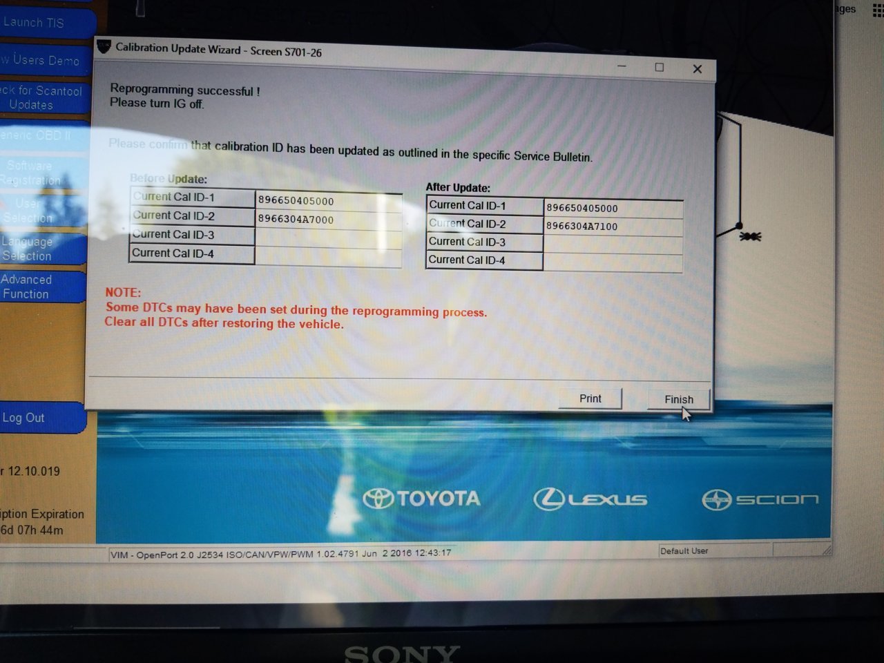

    Do I need to download drivers from Tactrix or are the necessary drivers automatically installed when I plug in the openport module?

    Get the drivers from Tactrix. Windows won't have the right ones. The driver DL and installation take a fraction of the time that TS does.

    Done. Takin' her for a spin now.

    Yep. That's the ticket bois. I dropped my phone and cracked the screen during the flash process but it was worth it, lol. That low-mid (1500-3000 rpm) pull is way smoother. It's not more power but delivery is linear and smooth like it always should have been. If I'm being honest it didn't bother me that much. It never felt right but I learned to accept it. In fact for awhile I figured it was just a characteristic of the motor but it was probably just the tune. Either way someone at Toyota knew exactly what the issue was and fixed it or sufficiently masked it to make it no longer an issue. Simple as that. Do highly recommend for anyone on the fence. If you think you need this, you need this.

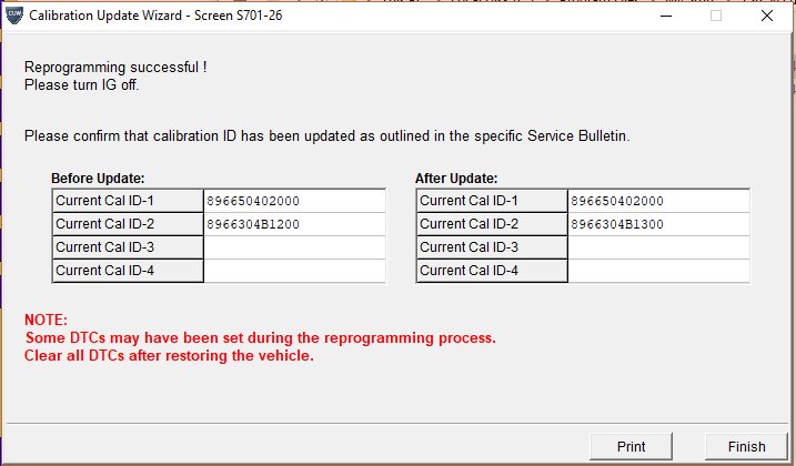

    Just a small heads up. Doing @WaTaco2018 's update with the TS version, we could easily update his ECU but could not check any customizations. Thankfully, Cariata was there to save the day. We made a few quick changes.
