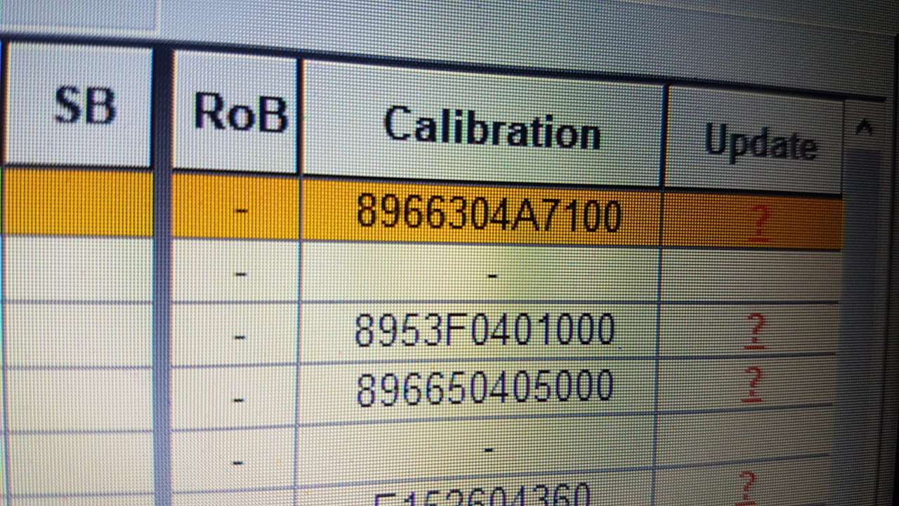

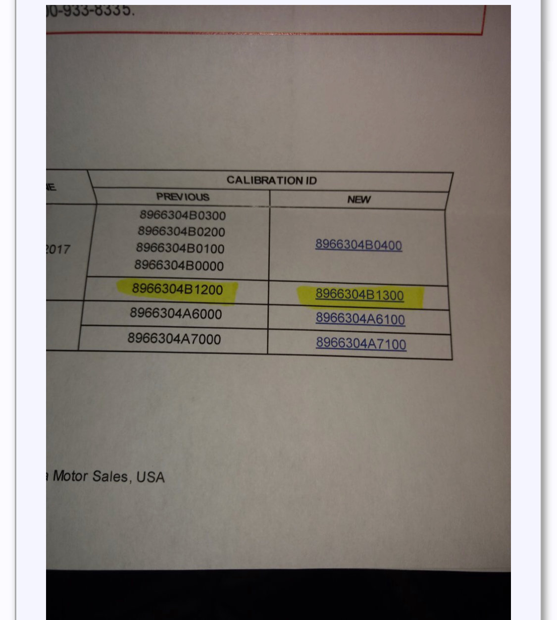

    Dropped it off this am. Dude texted me saying there was a torque converter so no good. I showed him the tsb and the diff pics. He just texted me and said they flashed it. Woot!!!

    I showed the service advisor these 5 pics and told him about the surge at 40-50 mph. Told him to hook it up to do a health check.
    He shut me down twice but was willing to listen. Picking her up now
