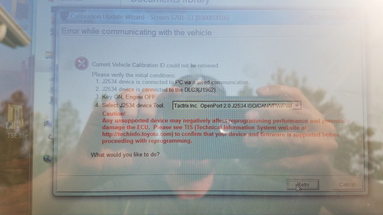

    Just got this error right off the bat. Any ideas. Should I abort?20180821_174650.jpg

  13. Aug 21, 2018 at 5:56 PM
    #1053
    TeecoTaco
    TeecoTaco Liberty Biberty
    Feb 26, 2017
    #211739
    10,990
    SW Ontario
    16 Taco DCSB TRD Sport 6MT
    Modified the level of gas in the tank
    Abort...then restart from beginning. Do you end up back at same spot?

  14. Aug 21, 2018 at 6:01 PM
    #1054
    nevadabugle
    nevadabugle Desert Rat
    Jul 25, 2014
    #134701
    3,991
    Elko, NV
    2016 DCSB TRDOR manual in quicksand
    Forgot to turn the key on. :anonymous:
    Success now. Taking it for a spin.
  15. Aug 21, 2018 at 6:01 PM
    #1055
    habanero_taco
    habanero_taco Well-Known Member
    Mar 24, 2017
    #214279
    293
    Randy
    2016 Tacoma TRD Sport
    OVTuned
    So your not connecting to your truck, maybe a driver issue? I had something similar. In my case I rebooted my pc, reconnect and all was fine.
