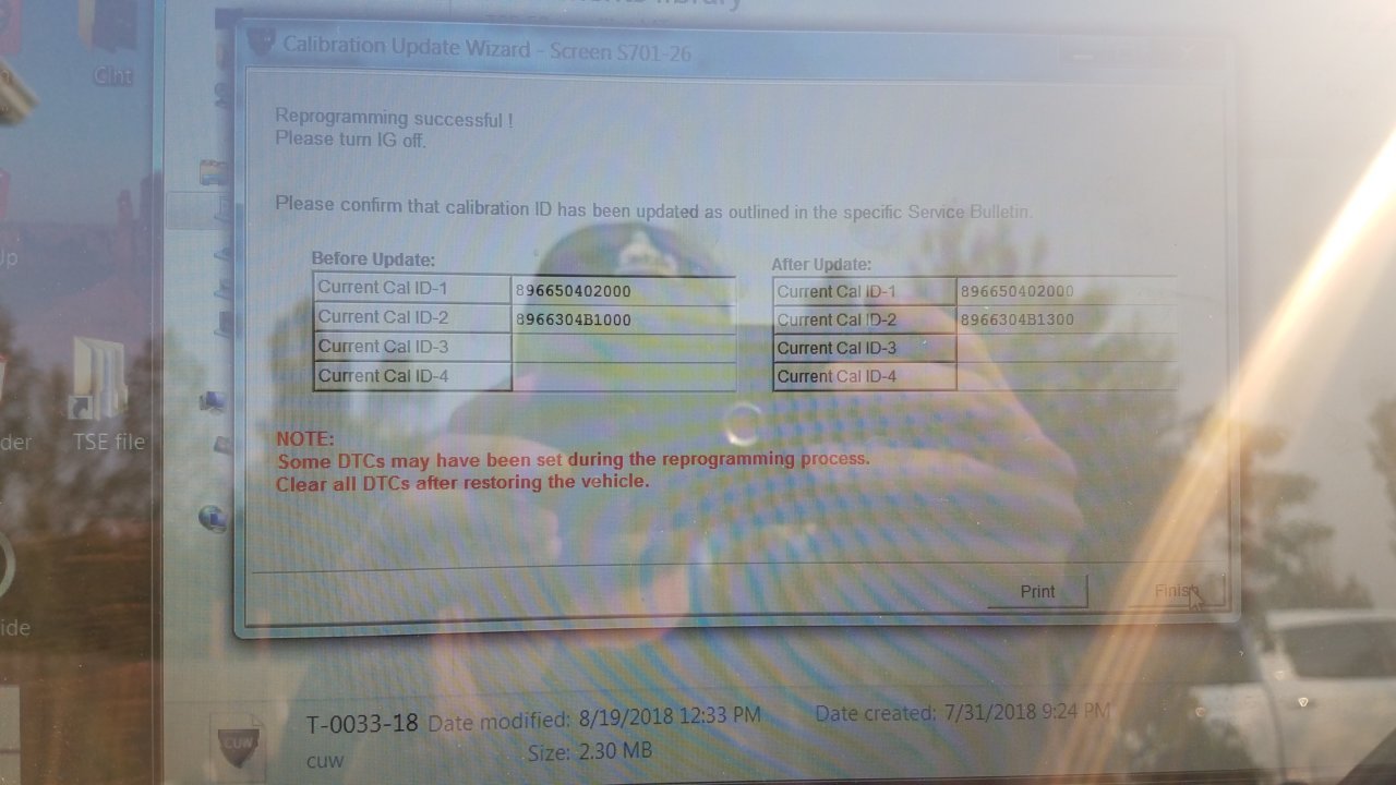

    Can someone tell me what the Note means after this update???
  4. Aug 21, 2018 at 6:45 PM
    #1064
    SContiVT
    SContiVT Back in a Toyota
    Jun 24, 2016
    #190444
    412
    Steve
    Central Vermont
    2010 Tundra Rk Wr/2023 WRX/2023 Ford Exp
    "DTC" - Diagnostic Trouble Codes
    aka MIL - AKA Check Engine Light
  5. Aug 21, 2018 at 6:53 PM
    #1065
    nevadabugle
    nevadabugle Desert Rat
    Jul 25, 2014
    #134701
    3,990
    Elko, NV
    2016 DCSB TRDOR manual in quicksand
    OK. That is what I was guessing. There were several codes that were flashing in the instrument panel during the flash, but once it was done and I started it up there was nothing. Should I open up techstream and check, or is this normal for it to show after an update?

  6. Aug 21, 2018 at 6:57 PM
    #1066
    SContiVT
    Jun 24, 2016
    #190444
    412
    Steve
    Central Vermont
    I've not run the flash yet.... But there's no harm in running a DTC check, but any OBD II scanner would be able to do that. If there's no Check Engine Light, the only thing you might see is stored codes.

    vF Tuned; ADM; Core SS
    Yeah lol, you always get a gong show of error messages while flashing - brake/override, low oil pressure, and of course the charge one. Normal, happens every time. Glad u got it done. Enjoy!
