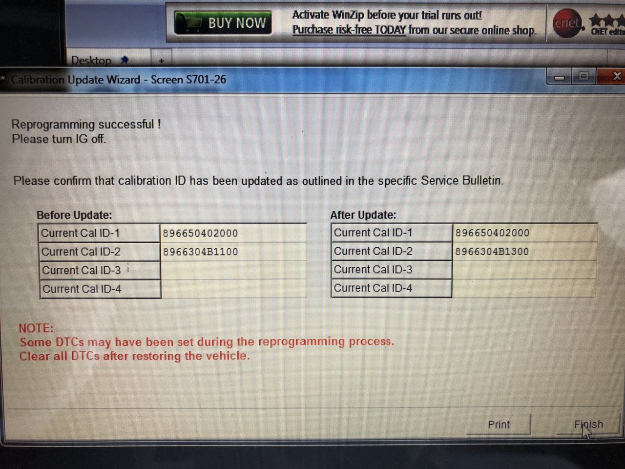

    I got mine updated to B1300 from B1200. I was able to get the dealership to do it. It took some conversation and some explaining and showing the update on TechStream, but the guys I went to are good guys to work with! Truck drives great and the low end power/Throttle curve response has increased and its a pleasure to drive now under 2,000 RPM. It is a very worth while update to get done.
