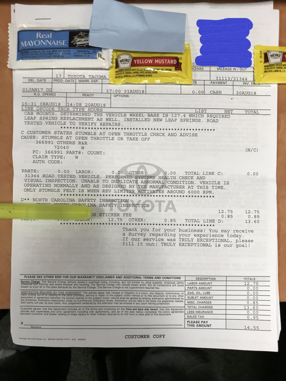

    Hold my BEER and WATCH THIS
    Its not a insulation pucks for them. its a new leaf pack. check the TSB, and read my work-order.

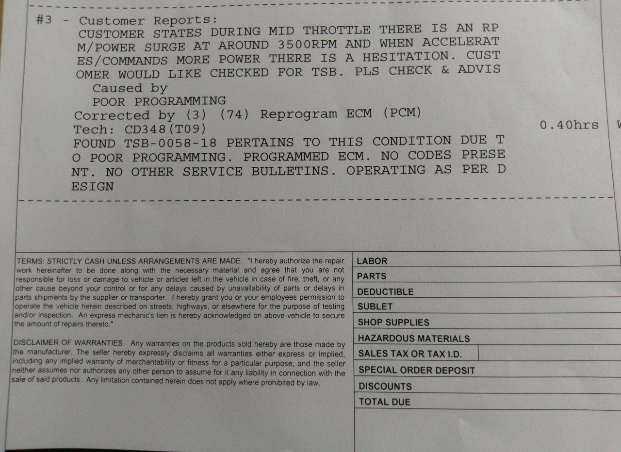

    I had the printed TSB and highlighted the 3 codes that are the "manual transmission" codes. It did take some massaging to get him to do it, but I told him he could be a superhero and send his knowledge to Toyota Corp and get it figured out for all MT's.

    I printed it out too, haven't whipped it out yet though. Talked to the advisor and shop foreman about it...foreman says it doesnt seem to apply but he will hook it up and look for an update. He said if it shows an update, he will do it, TSB or no TSB.

    I posted too soon...as I hit "post", the service advisor came out and said he was wrong and the foreman found an update for the manual ECM...it has been installed, and he said he doesn't know what it will do, but hopefully it fixes my issues.

    Success!!!

    Yeah it definitely made a huge difference. I've been driving stick all my life...cars, trucks, Corvette, forklifts, tractors...you name it...no issues. This is the first time I questioned my finness with the clutch. Now all is right in the world....I am again competent.
    The service advisor and foreman looked up in the software what was changed and he stated it takes input from the tranny and adjusts the fuel and air delivery. Originally they thought the software only changed the shift points in the AT.
    The clutch and gas pedals feel like they're in sync. My muscle memory is good, because now I don't have to think about feathering so much
