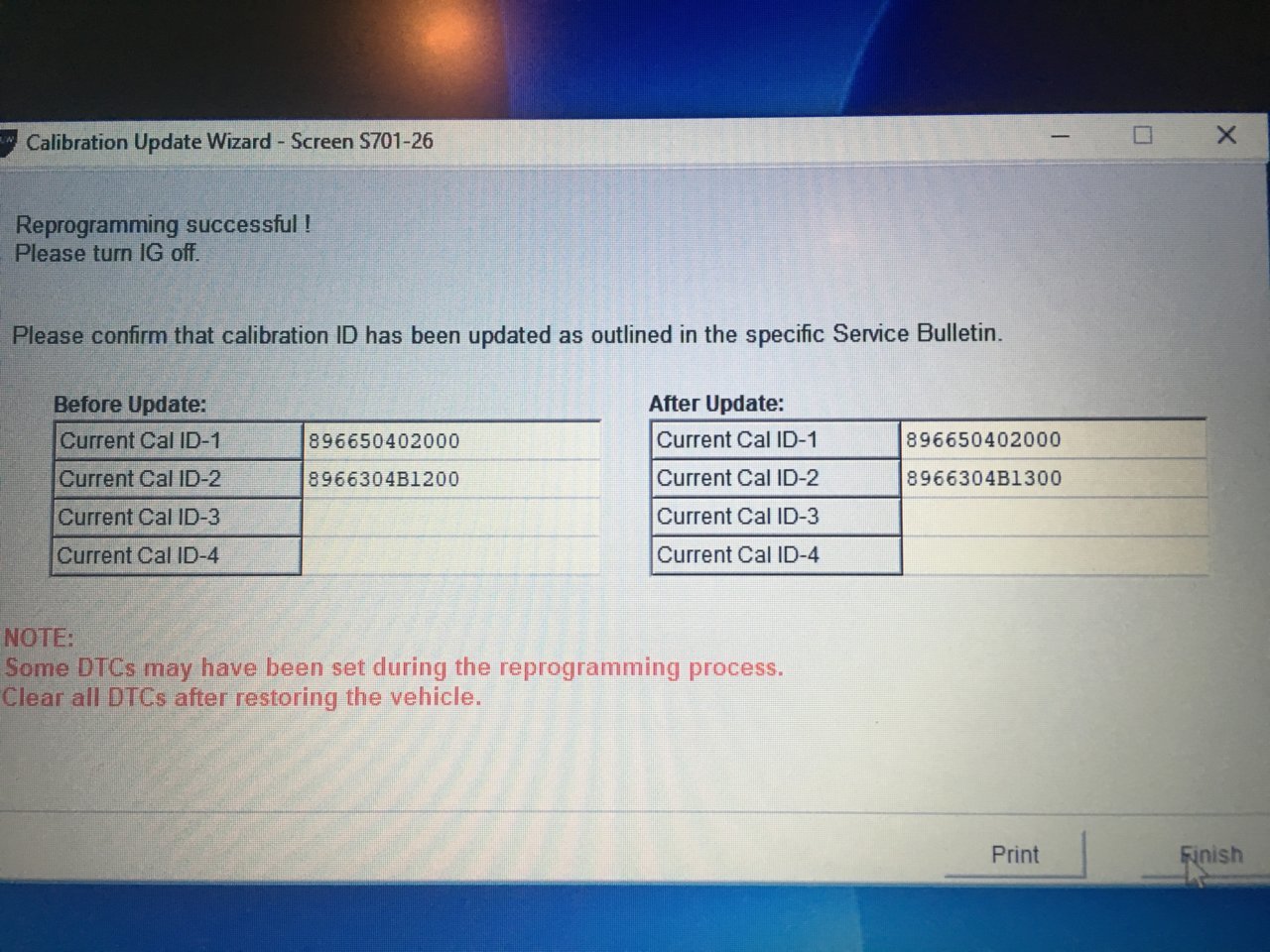

    17' inferno TRD OR MT
    5C42FA0C-B181-479E-807F-501016A6F582.jpg BOOM!! Hahahaaa. A little pucker factor but seriously took 4 min. To flash. Now I have to wait till morning to drive it. I only have a 5 mile drive to work so I might just keep going:)!
    Thank you Ruggybuggy and Tacoma world! Less rev hang and improved throttle response makes me not have to “think” about shifting! This was my only complaint about my truck. Only have 8 miles on the new flash but is noticeably better especially pulling out into traffic going from 1-2. Awesome. Well worth the price of the tactrix.

    I flashed without any problem by clicking on the file and ran the flash without opening T.S. however after the flash I opened T.S. to see if I could change some things, i.e. seatbelt chime, and when I tried to get techstream to hook up to the vehicle T.S. gave me an error saying that a connection could not be found. This might be a question for another thread but thought since there is a lot of knowledge here on T.S. that I would throw it out there.
