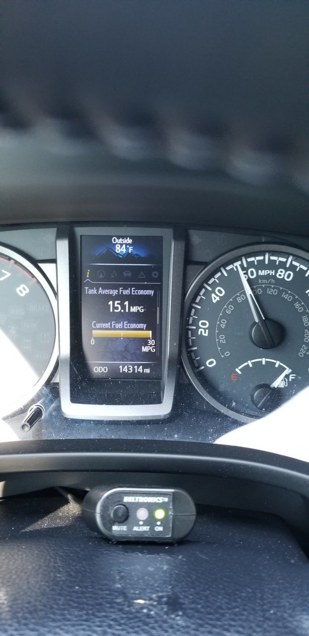

    Well this is my fuel mileage after a weekend of testing...
  2. Aug 27, 2018 at 8:10 AM
    #1262
    tonered
    tonered [OP] bartheloni
    Sep 25, 2017
    #231055
    31,240
    tony
    Lynnwood, WA
    Sorry! My worst tank was during break in at about 17.5. My general average before the upgrade was a steady 19.4mpg?

    The way this is tune is settling in for me, it would have to be a major upgrade for me to touch it though.

    That's all stop and go city driving. 1st to 3rd gears never even got to cruising speeds if I hit 30 I'd be stopping and accelerating again.
