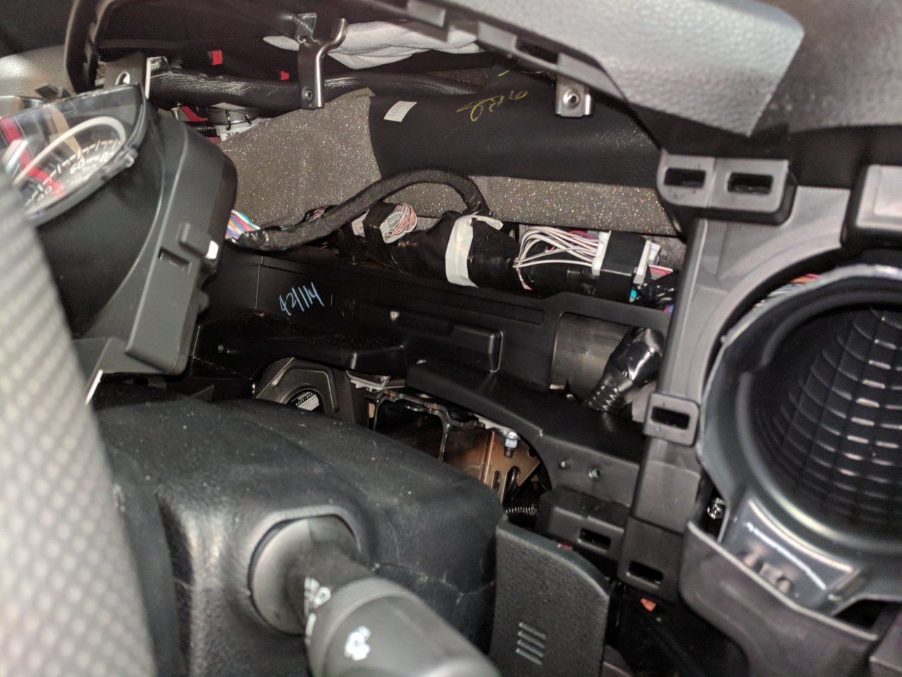

    That's interesting. It's easy to check. I pulled the cluster to take a pic of my Taco Truck easter egg when doing the vent ring stickers:
    That was before I heard the speaker was back there.
