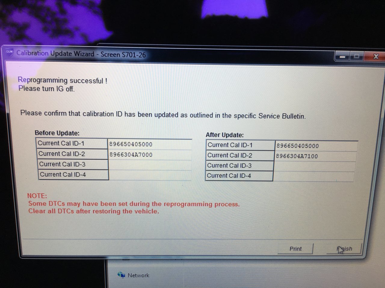

    Plus this, uhhhh, checklist:
    This was me:
    :anonymous: Don’t use hacked versions of Techstream for an ECU update.
    :thumbsup:Don’t use a virtual machine environment to do an ECU update.
    :thumbsup: Don’t use Bluetooth or WiFi dongles for an ECU update. (USB only)
    :anonymous: Do turn off Windows update service.
    :anonymous: Do turn off Windows system sleep functionality. Use the “always on” setting in power management pane.
    I don't know? Do turn off USB power management for the USB port you’re using.
    :anonymous:Do plug the laptop into a wall outlet. (but it is freshly charged and the update is very short)
    :anonymous: Do hook up a battery maintainer to the vehicle during an ECU update.
    :thumbsup: Do turn off all electrical consumers during ECU update.
    :thumbsup: Open the hood.

    I borrowed the cable. In the future, I will get a Tactrix cable. If you are serious, it seems like the best bet is going with the official one:
    https://www.tactrix.com/index.php?o...roduct_id=17&Itemid=53&redirected=1&Itemid=53
    You don't need any of the Subby or Mitsu adapters.
    One the big positive note, using that linked version of TechStream, you can do all the customizations that are in Carista for free (after you buy the cable). See attached.
